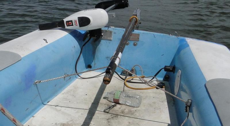

This doesnt regard the outboard.. but I will second what Douglast said about the tiller lock. I single hand a 15 foot real tippy sailboat often and to raise the main sail, Ill leave the trolling motor on at a low speed but most important is to have the tiller not flopping around. There is another product called I believe a tiller clutch that looks like it works well and is well made.
Another thought... is that if you have a roller furling on the jib or if the jib is easier to get up than the main, you could possibly set the jib up first and then get the boat into "hove to" (search on this forum or google) which basically stalls the boat in the wind and mostly works with the jib, keel and rudder. Outboard is not involved. I have not tried this for putting up the main but I use this all the time on a larger sailboat for reefing the main. You can be in fairly high wind, have the boat in hove to and have a fairly relaxed time going through all process of reefing the main sail.
I have a kludge experiment tiller setup at the moment but it works well enough that I haven’t changed it. It is simply a rope with a short piece of bungee sown in at one end that wraps once around the tiller handle and has a cam cleat at the other end. The cleat and bungee allows me to set the tension on the rope. When I’m sailing, Ill set it loose, don’t even know its there. If I have to leave the tiller, tighten it up at the cleat. I can still move the tiller when it’s tight but there is a lot of friction which keeps the tiller in place. I’ve seen lots of ways to solve this particular problem.
