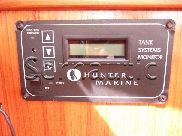

Hi,
We own a Hunter356 2002..Our gauges are on one panel and are digital and have never worked. We have tried to have them fixed and no one has been able to do that for us. The last attempt the mechanic told us he has been asked to fix these many times and they never work well..So, we are now looking for another option of gauges..Basically the fresh water gauge, as the fuel and waste tank we can clearly see..Water tank not as easy. Any suggestions and ideas for new gauge would be greatly appreciated!!
Thank you for any help you can offer.
Best,
Lauri

Which system is it,is it round with a toggle button on bottom that switches between water and waste.
I had to test it out myself and my water part worked perfect but the waste did not and after going to the manufactures web site for instructions on testing the sending units and mine were good and than found out was a bad connection on the waste side and did order a new round gauge and than the waste part worked but not very accurate but the water did work good and I also can see my waste tank and gave up with the waste part.
I am trying the unit that sticks to the out side of the waste tank but no
luck so far.
Try testing the water sending unit in the water tank.
nick

It is the one pictured below that came with the boat. None of the gauges work..The gauge always shows them full..We are not concerned with gas and waste, as much as fresh water...Hoping for suggestions...Thank you again!

Level gauges have a sender and a display. The water tank is normally the easiest to monitor. I guess i wouldn't give up until i knew the problem. Then you can make a good choice if needed.
Perhaps your sender is fine and your digital display is "haywire"?
That mechanic's advice you got was really good. Geeezzz I don't know how to fix them.... errrr uhhhh... I mean "they never worked so well"
Look at the "Sender" on the water tank for information. Maybe there was a factory recall?
I replaced my 14 yr old senders when I found the floats were "water logged" ($42 each).
I found one waste tank float in same fashion ($35).
All work perfect again.

Our tanks are large "frosted" plastic tanks..all three the same (not size of course, just construction) (water, fuel and waste)..Our waste is easy to get to and see in back locker of boat near swim platform..We have electric fresh water and are crazy about keeping that all clean and fresh! The fresh water tank is really the only one we feel we need to have gauge/sensor for...The picture that I attached previously showing the gauge panel, has a recalebrate button..We have done that, as well as the mechanic and no luck..Anyway, definitely do not want to run out of water while sailing..Hope to find a solution for this..

I have the same gage and the sending units are metal tape on the side of the tanks. You need to calibrate for both full and empty. I replaced the holding tank and just replaced the aluminum tape on the sides of the tank and recalibrated. Works great now!
Just make sure you're on the right tank when you select calibrate, filling and draining the water tank and waste tank are easy. Not so easy for the fuel...ops

Your tanks are HighDensityPolyEthylene (HDPE) and will allow the use of the "metal tape" on the outside. If there is no internal reference probe, then they are basically using electrical "conductance" and normally have 2 strips (some newer types have one combined). Kinda like sonar sound pings. The conductance of air versus water is significant enough to be calibrated like kjretlaw said.
This type of level sensor is HDPE tanks only. Metal tanks ground out the conductance. Double check that your metal level strip (s) are in contact with the tank sides and do the calibration he said.
Helluva lot cheaper and it is top of the line sensor. These types are not precision levels but good to at least 1/4th ( 25%) tank changes or maybe 1/8ths (12.5%).
Note: Don't ever top off a HDPE tank, they will flex and after many overfills, crack the seams. I can see mine swell like a balloon. So try 90% full, since the sensors are not too precise or visually verify your Calibration. In other words set 100% full on gauge calibration when tank is not totally full by eye ball.
