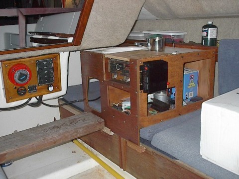

howdy neighbors, i have noticed comments in the forum more than once about the "light-duty" electrical panels that come standard on the water ballast hunters. i am also starting to notice some of the plastic lock-nuts on my panel (a 23.5) are cracking so it's just a matter of time before one fails. i plan to replace the plastic nuts with metal ones, but for the long term, wondered if anyone can recommend a more durable but reasonably priced replacement panel that fits well into the space available. thanks, ed

not too hard to build one to suit you.
i too thought the panal on my 23 was a little cheezy. i built a new one from 1/4" a-c plywood to hold what i wanted. i reused the oem switches, and just enlarged the panal and added a few things. (still need to add another 12v outlet tho.) it wasn't too hard....5 min epoxy and screws. i really don't have plans for it and i am certainly no cabinet maker so if i can do it almost anyone can. (perfect joinery is easy for those with a belt sander.....glue it all up and make it square and pretty with the sander...just like chippendales ;-) there's plenty of room to work in there now. add some corner moulding, 2 coats of cetol 1 and 3 coats of cetol tgl high gloss over that and it should be pretty close to water proof. i'll be glad to e mail with more detailed "instructions" and or pics if anyone wants.
