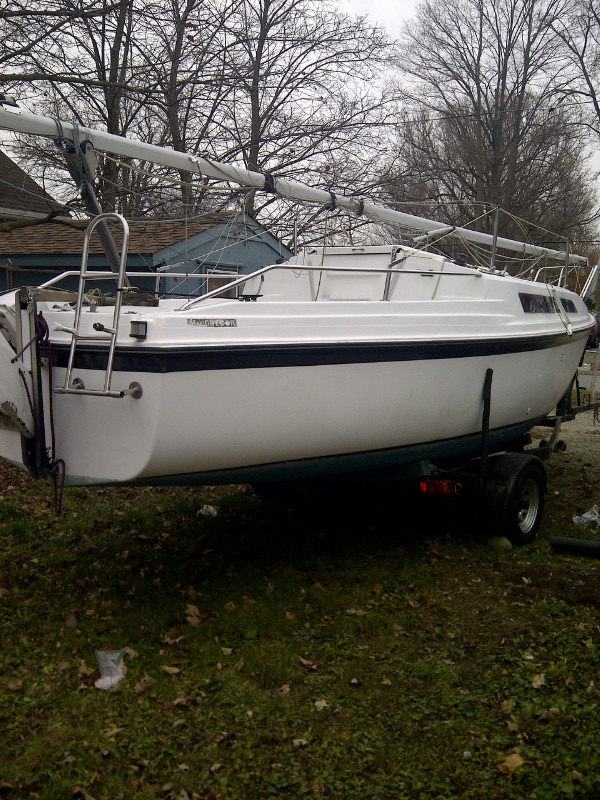

Hi, I just purchased a 1989 Mac 26d with a trailer that may be a bit too small; OK so whene I unhooked the trailer from my truck it slowly settled backend down in my yard. The good news is that if I back up to a boat shop I can put that back end into the shop without driving over the sidewalk.
I'm in the Everett area north of Seattle and I know there are a lot of Mac owners out there, and that they like to repalce the Mac trailers for something else. This is an early water ballast style and has the standard round bottom of the classic Mac. Does anyone know of one or of any shop that takes in traliers for trade ins that might have one for sail. I'd like to get one that extends a little bit so that I need not have a submersible to launch it. Or any other trailer that they have found that works well for their Mac 26's of the same type. Thank you

The factory trailer looks too small to begin with. You may have the boat too far back.
On solution is to move the axle back a foot. Search the threads under MacGregor owners and you may come up with the answer.

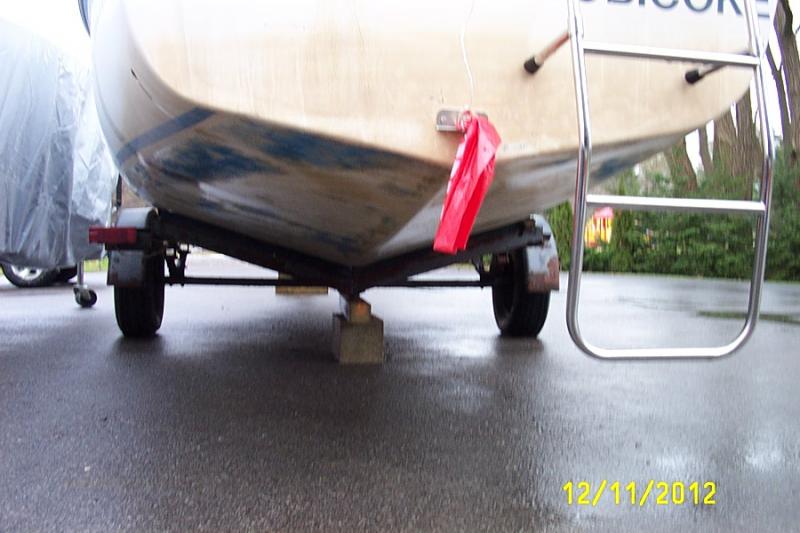

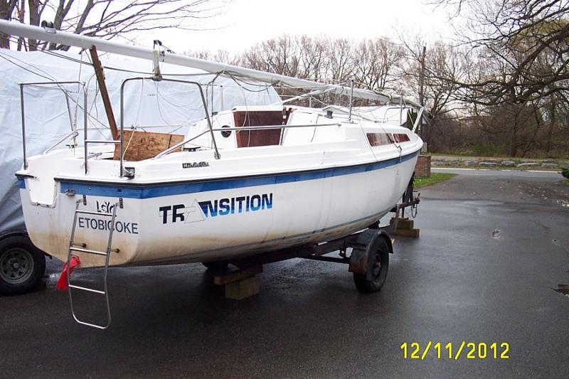

Here is a photo of how much of my 88 26D hangs off the back. And another boat different angle.
Note that the lights are about the furthest thing back on the trailer and in the 2nd photo... blocks of wood keeping the back of the boat from tipping back when you climb up on it.

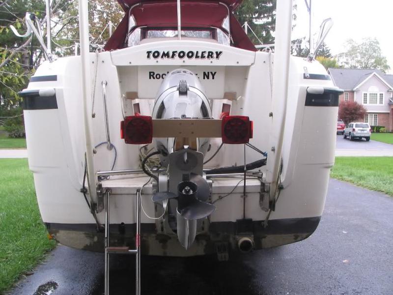

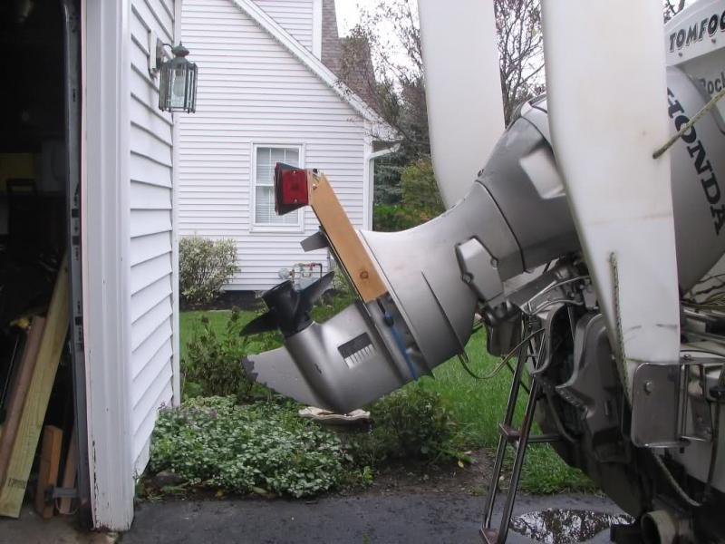

Most state highway laws allow 4 feet overhang beyond the marker lights without having to have the load flagged, indicating an oversize load.
That being a real concern, I mount a second set of tail/stop/turn/side marker lights right on the outboard, which is pretty much in line with the end of the mast, so no overhanging load issues. The trailer lights are permanent, and include clearance and ID lights, but are 6-8 ft (don't remember exactly, but pretty far) forward of the end of the outboard and mast. This way I have lights without the boat, and for travel I have legal load marking, so no need for a red light on the end of the mast. Plus, the brake lights are right in the eyes of someone following too close, in the dark, while it's raining, in heavy traffic, on the highway. :eek:

Here in Ontario Canada the overhang limit is 1m. Over that you need a flag. At least for vehicles.... I'm not sure about trailers. (I always have a flag in every vehicle. Not because I'm a safety nut. I just happen to find allot of big things on the side of the road.)
I will have to look into what the laws are here. I just kind of figured that Roger would have known about the different state laws and made the trailers to accommodate the minimal law requirements. Did the boats come with a red flag on the end of the mast from the factory?
Here is another photo kind of from the side. It looks like it hangs over about 7'.
