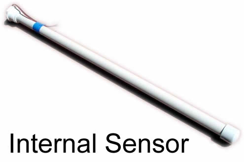

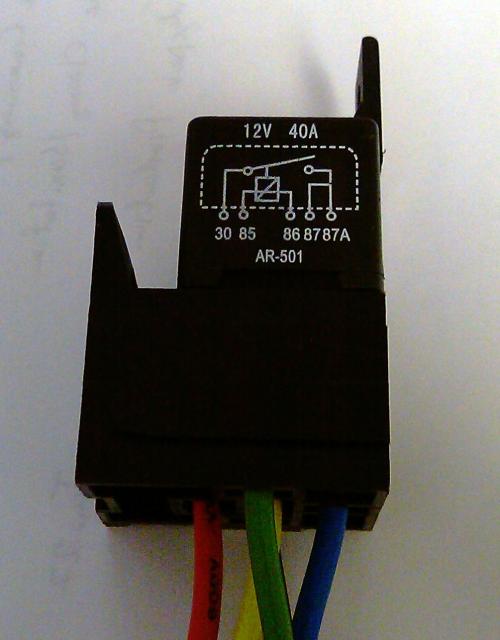

I've become disillusioned by some of the switches on the market and decided to construct a non contact bildge switch and control module. The switch is based on the non contact level sensor used with the Scad tank level sensor. This item can be bought just about anywhere and can be cut down to 6" which works in my application.The control module has a LCD display to allow selection of pump trigger point, on /off time of pump and pump on counts. The relay used to switch pump is an automotive 12volt 40 amp contacts. I will report back how it works out if anyone shows any interest.This is a DIY project.
