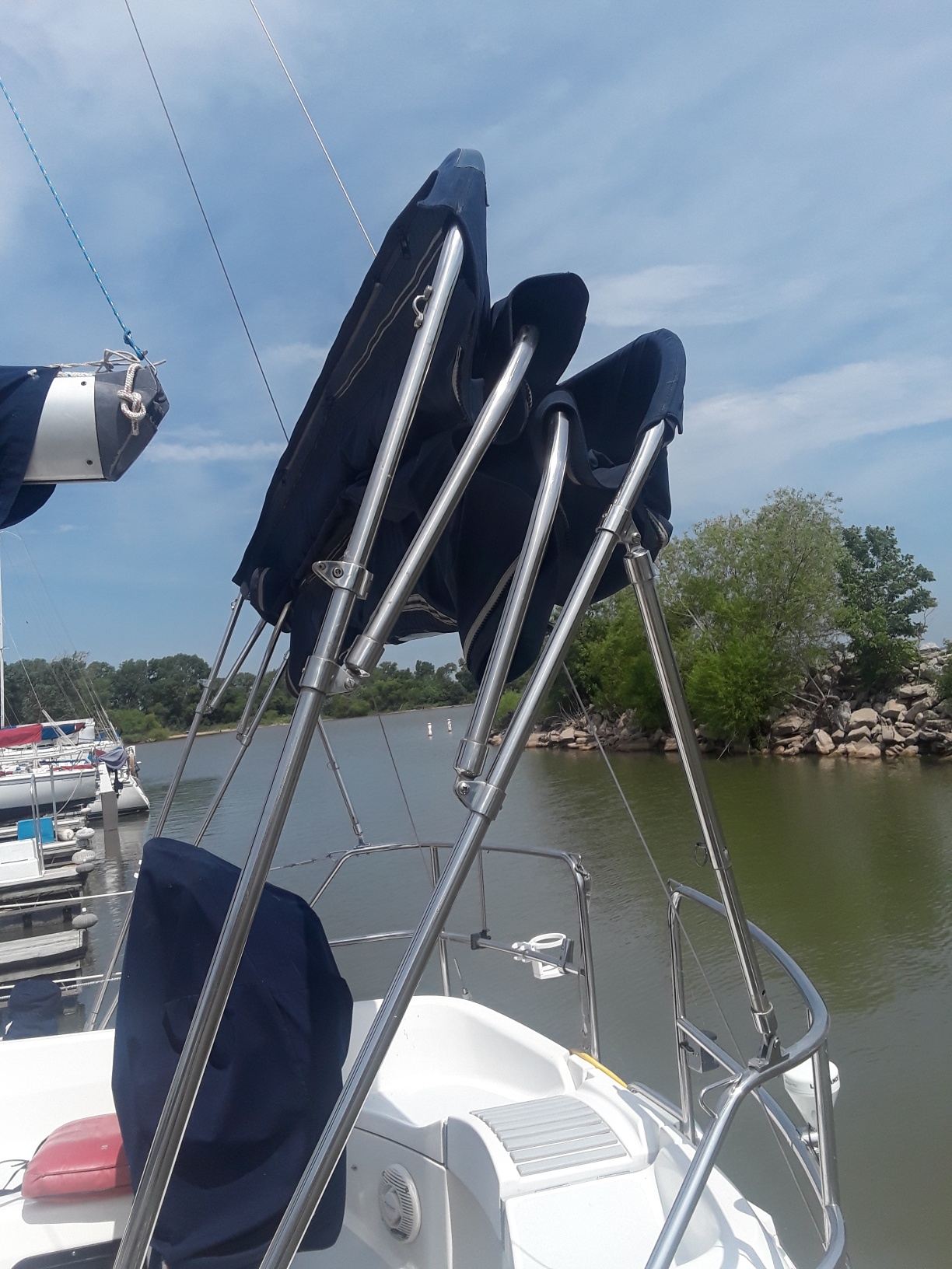

Thanks for all the tips folks. I ordered a SS tube cutter on Amazon. My tubing arrived this weekend. It's part of the stern rail telescoping "back strut" for my bimini. Since I modified the framework so that the bimini can now be closed and covered. the adjustable struts need to be a little longer.
