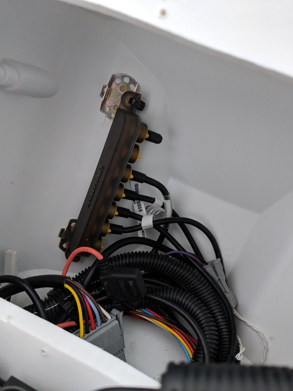

Scott we have about the same system, 2 Triton2 displays, radar, Zeus2, Autopilot. Here's a photo of the brains of my system. You can see how I strung together 4 Tees with a terminator at the end.

Nice installation! Mine was a tangled mess underneath the quarter berth last summer. I'm working on making an organized cabinet to fit under there this year. I actually have 3 cables into the helm pedestal. The autopilot and the power cable for GPS were not a problem. The N2K cable for GPS is the one that I need to splice. I should have looked at the Maretron manual first for clarification. I was questioning about the bare "drain" wire in the cable before.

Are you sure? Beneteau left blanks in all 3 manifolds on our boat. They just put one terminator on the end of the MFD manifold. Not to say they did everything else perfectly, but still...

I have to go reread the spec but seems like good practice as the signal lines are open to stray rf if not covered. Just like loss of shield for short bit.
Plus chance of something shorting the pins.

The Maretron manual said a little bit about that. They indicated that the beauty of the system is that various components can be removed for servicing without disrupting the other components. I think that means some open drops would be ok. However, I would only consider that temporarily. It's so easy to insert or remove a drop Tee in the middle of the manifold that it wouldn't make sense to install anything that is intended to be left open.
