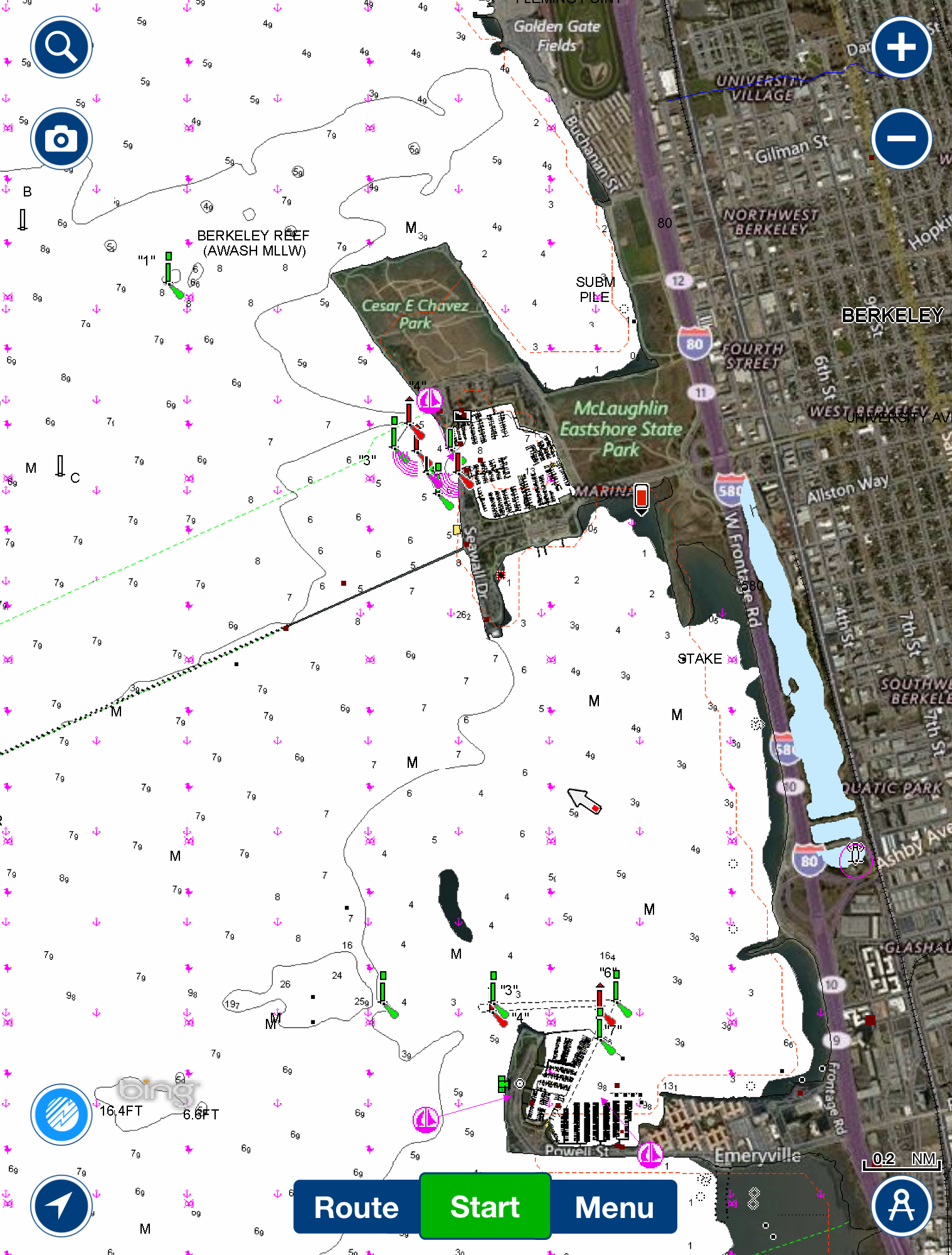

I'm new to this, so please bear with me. I just got a Raymarine Axiom 7 chartplotter with a Navionics chart. The chart shows detphs in feet but each depth is indicated with two different numbers, one of them in smaller font. Can anybody explain? The chart looks quite cluttered like this. I'll appreciate your comments.

Larger (regular font) number = full depth unit (Meters or Feet)
Smaller (subscripted) number = 1/10 depth unit
Where your depth unit is set up on the chart plotter or Mobile App as feet or meters.
As for congestion on your chart, you may be able to set the amount of detail the chart displays, on my Raymarine it is under "Preferences" I believe. If you zoom in to a tighter view the congestion will disappear as well.

It’s what daydreamer points out. I find this happens a lot in areas where the original soundings were done in a unit other than the one being used on the chart. Like California. Personally, I think this is fine for meters but I’d be OK with rounding in feet.

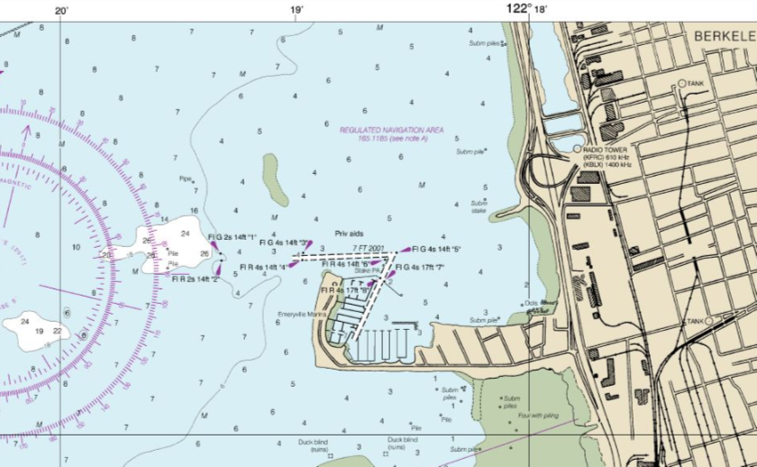

Not to add confusion to this but, when I bring up my iNavX chart of the same Berkeley bay location using the NOAA chart 18652_5 I see the same numbers. The NOAA charts are in feet not meters.

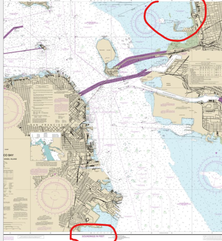

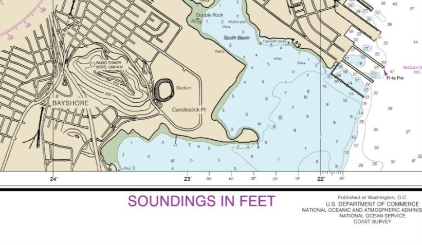

Some NOAA charts state bottom right hand in the border, "Soundings in Feet" just wondering. There are also NOAA charts marked soundings in Fathoms, I guess it depends what chart is ordered.

Check your settings in the Navionics app. It will display in either feet, meters, or fathoms, depending on how it is configured. (Under menu/settings/units). Small # is 10ths.
edit: that's where you find the display settings in the Navionics app. Assuming your chartplotter has a similar setting configuration.

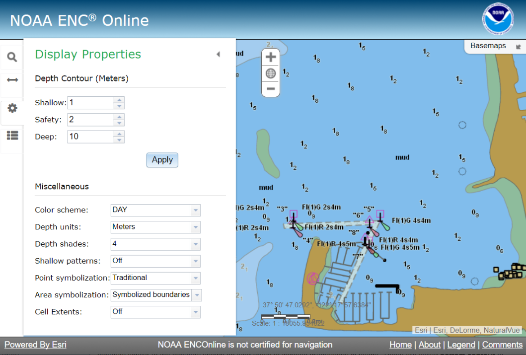

iNaxX uses RNC (raster) charts that will only display soundings in the original unit of chart measurement. ENC charts allow for the sounding units displayed to be changed under programmatic control.
