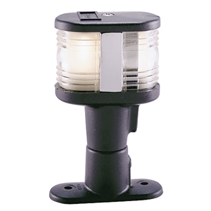

I believe the boats came with a Perko Fixed Mount Combo Masthead All-Around Anchor light, like this.

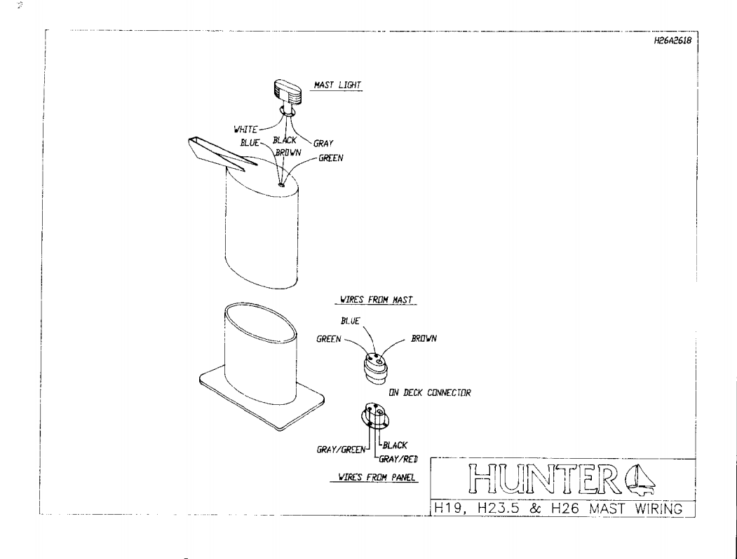

The owners manual depicts the same light.
Mike, are you saying there is no light at the top of your mast? Was it removed for some reason? Is there a wire with connector coming out of a hole at the base of the mast?

Thanks for all the posts. This is what I've came up with. I do have the Perko at the Masthead. Which isn't working. And the combo on the forward Pulpit is there but only the Green is illuminated. The Red isn't working. There is no steaming light midway on the mast. They just didn't install it. Kind of a bummer and I don't understand they're thinking, since it is a required navigational light. When I drop the mast I'll have to make the repairs and add the steaming light. The interior has LEDs..... so I would have thought there would be LEDS for the Nav lighting... but not. But I'll add as needed. Thanks for letting me have all the info. You guys are a great help indeed!!

Mike, the Perko is a double light. One bulb forward/steaming, one bulb aft. When both are on you have an anchor light. You probably just have burned out bulbs, or dirty connections.

The light at the mast head I bet does not work because of the deck connection. clean the contacts and the socket then try a meter and see if you have power at the socket.
