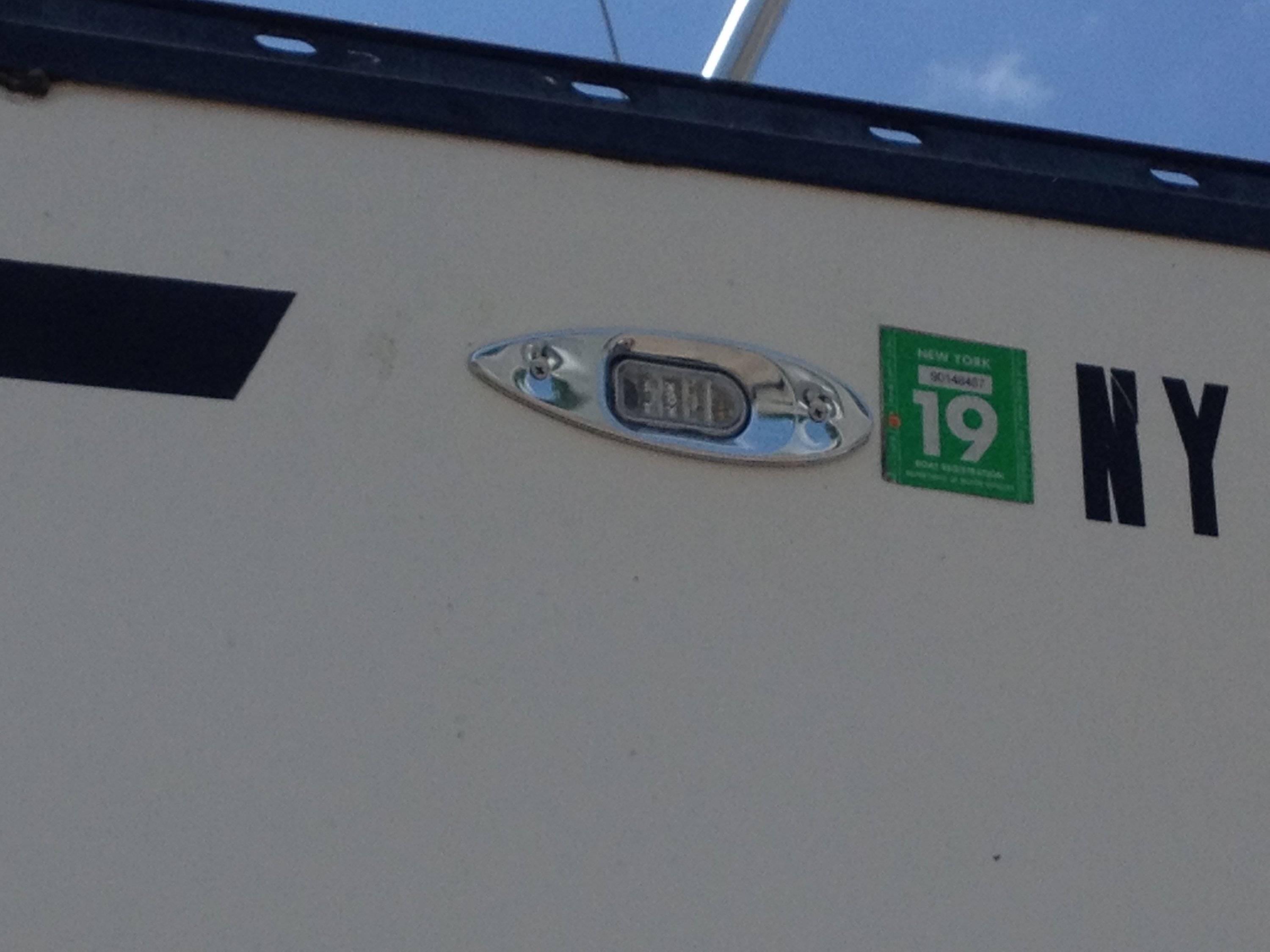

Andrew, we've replaced every incandescent light bulb or fixture with LED's. I was amazed at how easy the entire swap was. The LED's are super bright and my favorite replacement was the bow and stern nav lights. The Hunter has flush mounted lamps for port and starboard and I found these on Amazon. Two screws and two wires...done.
https://www.amazon.com/SeaSense-LED-Teardrop-Lights-Green/dp/B004XAD5DW
