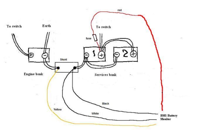

@Philip_Oceanis 361 - forgive my lack of understanding on this, does your sketch match this one (below) that I found on the NASA website? Once the shunt is in the negative circuit, does it detect the whole battery bank with the engine battery switched in? Apols if some of this falls into the 'daft question' category!!

Beneteau Oceanis 361 Clipper --
Thanks again.
SRB
http://www.nasamarine.com/prodimages/one_battery_wiring1.pdf
As you can see I have one negative for both services and engine (probably common to most boats) but they way the shunt is connected measures only (hopefully!) the services batteries.
