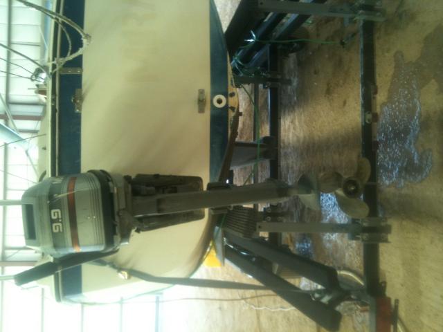

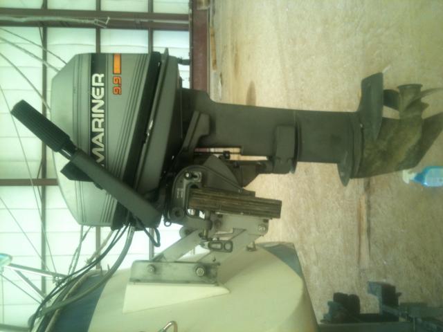

Ok, so by now if you've seen my other posts you know I'm a total newbie....and here we go again. How is this thing supposed to work? The motor tilts and that's what I've been doing out on the water but this thing looks like it's made to go up and down. Right? Why? When?

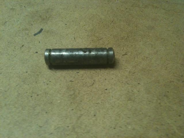

I must not have been using it properly because the metal pin shown below was spat out at me the last time I touched the mount. Clearly it's not pleased with me. Any advice on how to live happily with a motor mount would be greatly appreciated.
One last note. It's a crooked mount. Not morally (as far as I know). It's what we call some folks when they appear to be a little weird, "Half a bubble outa plumb." Should this be an immediate concern and how should I address it?
Thanks!!!

Get a gear headed buddy to look at it and figure it out.. That pin should have a “circlip” in the groove on each end to keep it from coming out of the “wherever it is supposed to be”.. There was probably a spring someplace close to lock this pin into a slot or groove to hold the engine up out of the water when sailing.. Usually, you’d tip the motor up and then lift the bracket and it would latch in the up position to get the motor completely out of the water while sailing or at the dock.. If ya google a bit on “outboard motor bracket” (or mount) you can probably find that bracket with pictures that will let you decipher the puzzle.. Yes, I would try to get the motor a little more vertical by adjusting the clamps of the engine itself .. but I’d not mess with the lifting bracket to accomplish that.. straightening the engine will make the oil reservoir operate more like it should.. Good luck with it and WELCOME ..

The bracket is to raise the motor up when not in use.
When I had my O'Day 222 it had a very similar bracket. I did not need to tilt the motor, simply lift it up or lower it down. In your picture I can see a part of the bracket that has a grey knob sticking out the side. There should be an matching one on the opposite side. Its down low in the picture just above the screw in lever that tightens the motor to the bracket. That bracket piece also has a slot down the center of it. The pin you are saying fell out probably belongs in that slot, and it rides up and down the slot as you raise or lower the motor.
Standing in the boat looking down, you would reach down with one hand and grab that piece by the two knobs, and push the bracket back a half inch or so to release it and then lift the motor/bracket up until the handle you are lifting with snaps into another slot where the motor would ride in the up position. Looking at the slot in the picture you can see a notch at the bottom of the slot that is what the pin slides into when you complete the step I describe above. Hope this helps.

Old motor mounts are notorious for freezing and generally malfunctioning. They depend on springs to provide a counterlift force to allow you to raise the entire unit (as you suspected). If the mount has been in one position for a long time, the springs will get "tired" and no longer function very well. This will make it very difficult to raise and lower the engine, as you will be fighting almost the entire weight of the outboard with no assistance.
The design of the Oday 23 cockpit and stern railing make raising and lowering an outboard difficult in any instance; I have found that its just impossible to get good leverage from the cockpit. So even when my outboard mount was new (and the springs in good shape), I would leave the bracket in the lowest position, and always relied on the outboard's own tilt mechanism to bring the unit clear of the water.

Looks as if your motor bracket does not have a spring to assist the lift - or if it had one it is no longer there. Some do, some don't. It depends on the weight of the motor (and the physique of the motorboater!) -
This guy has solved it in his own way. Lousy photography but you will soon get the idea. http://www.youtube.com/watch?v=M-SqrKl24gA
Also it looks as if your mount has been deliberately inclined inwards at the bottom to get the motor thrust more in line with the centre line of the hull, though this hardly seems worthwhile. Anyway your engine will not mind this extra little bit of heel.
