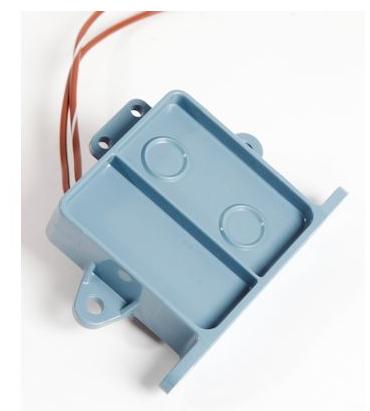

I, too, don't trust mechanical float switches. The one on my boat was working OK but last week I decided to replace it with one of these: http://waterwitchinc.com/new/SiteElements/Pages/ProductPages/101product.html
Installation was a piece of cake and it seems to work just fine. The other thing that is nice is that it takes up almost no room in the bilge, so it's great for installs where space is tight.
