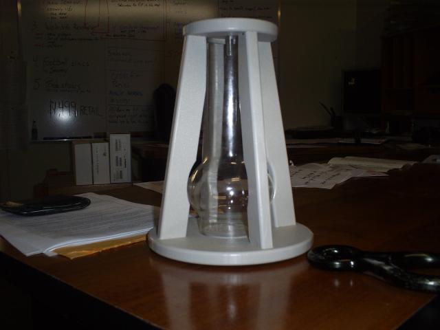

I got the light online for like $5. I made the lantern thing. The lantern glass was discontinued from defender or hamilton. I made the plastic lantern parts for free.
My investor and his ridiculously rich father in law updated their home entertainment centers. I get the 'old' stuff. I have 3 50' long high quality RCA jacks cables. I am going to make it a power cord for my little lantern and hook it to the battery bank. This is temporary until I wire the anchor light.

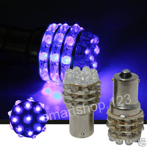

I bought this bulb on Ebay 2 for $14 with free shipping. I had to remake the old wooden holder to accommodate the larger bulb. I made it out of a two inch thick piece of nylon plastic I had sitting around the garage. Actually I had my 88 year old dad turn in on the lathe. He hadn’t use the lathe in years but boy was he proud. The bulb is way brighter than the incandescent bulb that was stock. What is also cool is that the new translucent nylon base also glows.

While your improvisation is neat looking it appears to have several dead spots in its 360 degree coverage. Given that you are going to use a "point source" led it WILL have directions that you can't shine a light in. the arms will be lit up but they will not have near the required distance of the light proper.

excellent point! I am going to run those vertical arms through the router to make them thinner at those parts around the light. That should help but I don't know how much.
The glass is set in tight holes on the top and bottom, I am going to seal those with a rubber gasket to waterproof it so I don't get any condensation inside. I don't have any lights that aren't leds on the boat.

Lucky you!!!! You will have a blast. If anything happens and you need help just give me a call and I can be down there. That light will be fine, If you hang it so it can spin it will be fine. Also I am buying the LED christmas lights to run up the mast on my boat so they are up and down the forestay and backstay. I think that will be obvious to others that I am sailboat at anchor! I have half a mind to come down with my C22 and follow you around for a week!
