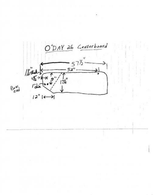

Anyway, back to your question..... below I've posted a sketch of the O'DAY 25/26 centerboard in case you need to make a new one. I too have my doubts that the whole cb has disappeared, it may be hanging by a thread..... but....
