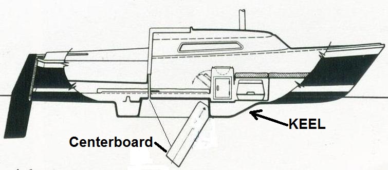

Your boat's bottom is pretty flat, but does certainly have a KEEL.
The CENTERBOARD, housed inside your boat's KEEL may have jammed up due to mud or other stuff getting wedged in te slot along with the centerboard, or if you were able to get the centerboard down during your initial trip (or a previous owners did?), it is possible that when you went aground, the CB may have been pushed up into the keel slot and the rope pendant used to pull it up may have become jammed between the CB and the sides of the CB housing in the Keel, or it happened as you pulled the boat back onto the trailer. Your CB weighs around 25-30# (just enough to let it drop easily) so a little jiggling from below (either after lifting the boat out of the water by crane or Travel-Lift, or by diving under the boat in the water, I've had to do it on my DS II by diving underneath) may free up the CB and let it drop. Always pull on the CB pendant to raise the CB as the water gets shallow or pull it in as the CB gets pushed up by the water getting shallower, to avoid the line getting stuck again.

O'Day trailerable cruisers (192, 20, 222, 23-1, 23-2, 25 ,26, and the 1979-83 version of the 22) all had KEEL/CENTERBOARDS, where a lightly ballasted (as I say, about 20-40#) Centerboard was housed inside a shallow fixed-keel. The Keel contained all of the ballast that gave the boat stability, CB weight contributed very little if any stabilizing force, only helped CB to easily lower out of the keel. The Centerboard on these boats could be easily controlled by a light (1/4"-5/16") line that even a child could probably use to raise/lower the CB, no winch needed.

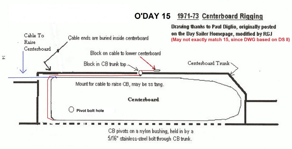

I have an O'Day 15. Any help here? It is not a weighted centerboard. It only moves about 15degrees then gets stuck I rolled the boat over and manually moved it, but it seems bound somewhere.
Thanks in advance

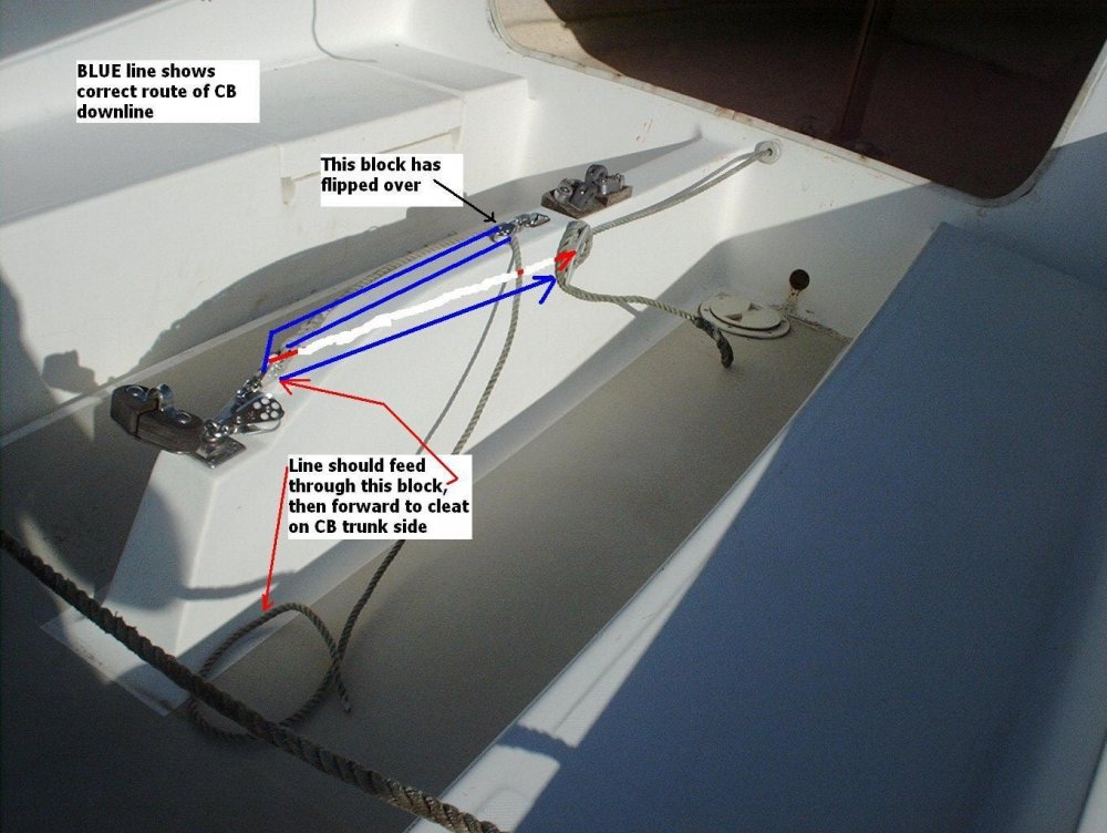

Thanks in advance
I wish I was more familiar with the setup of the old (early 1970's) O'DAY 15 centerboard, but based on my knowledge of the similar-vintage Day Sailer II and Widgeon, I wonder if one of the CB control lines is wedged between the CB and the side of the CB trunk? I note that the 1971 Rigging Information that I have describes CB operation on the 15 as the same as the DS II and Widgeon, so my guess about your problem is that the cable that pulls the CB down has slipped off the top edge of the CB and is wedged alongside the CB in the trunk. I know this was a common problem on the DS II at that time. I'll post a few diagrams of the DS II Centerboard rigging from that vintage, though not exactly the same as your 15, it may be close enough to help.
