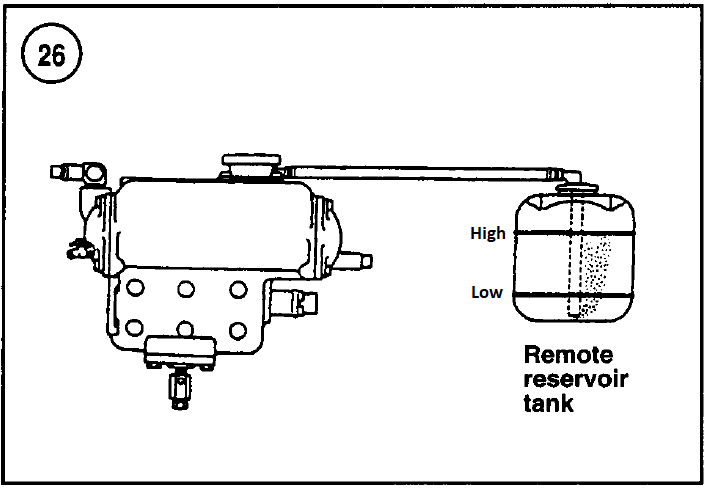

Confused new owner of not so new 1987 Hunter 28.5. Please help! I do not understand the closed cooling system for the Yanmar 16hp. There is a remote fill line in the starboard hatch in the cockpit. It is full of antifreeze all the way to the cap. my questions:
1. Should it be that full? Concerned it will expand with motor running.
2. Is this the only coolant fill for the engine?
3. Should the freshwater tank be full? I ask because it looks like there is a heat exchange between the engine and the hot water heater.
Thanks for any advice to this novice!

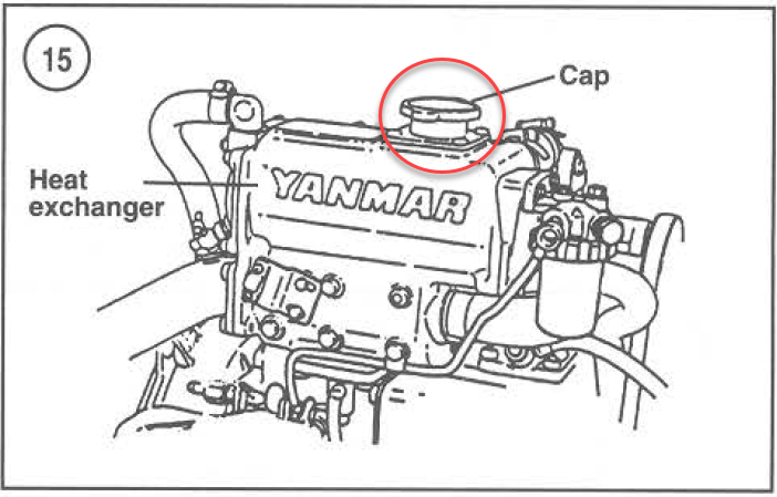

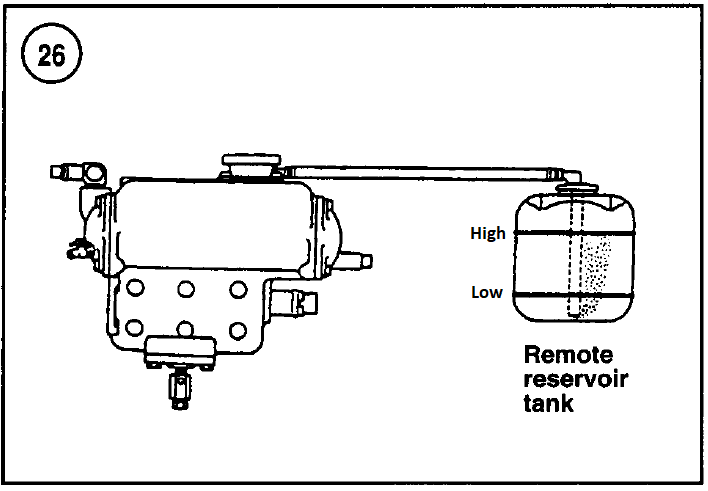

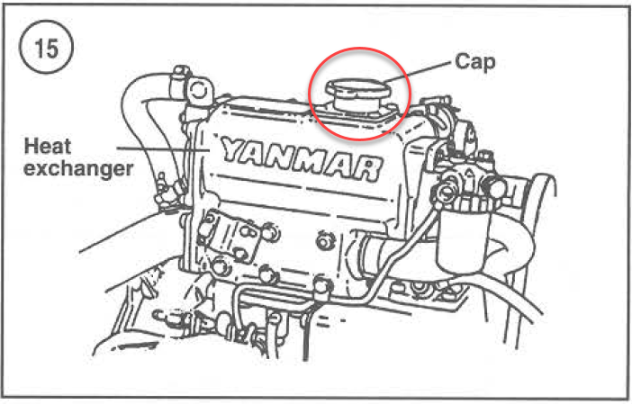

I'm assuming from your description that you have a Yanmar 2GM20F which uses seawater to cool your engine coolant (so-called "freshwater") using a heat exchanger attached on the engine. The fill cap is on the heat exchanger at the engine. Connected to the fill cap on the engine is a hose that runs to a remote expansion tank which should have an upper and lower level marked on the tank. The coolant level should be between the marks on the tank when the engine is cold. It definitely should not be full all the way to the top of the tank. You should dump a little out when the engine is cold so that the remote tank is half full. If the remote tank is empty, you should add coolant at the heat exchanger, otherwise you can just top it off at the remote tank.
