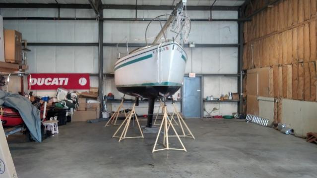

Ok, thanks. So, I imagine I should be able to feel the difference by touch comparison? Won't be sailing her anytime soon though, pulled her out just before Sandy hit!
