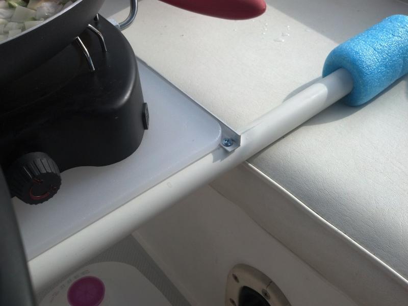

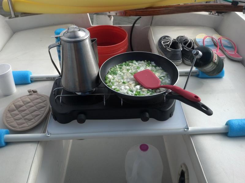

After discovering that I prefer to cook outside, I built this little table. 2 pieces of PVC (40 in. Each) with small angle aluminum bolted at a spacing to fit a 15x20 cutting board. When finished cooking the board pops out allowing the frame to fold for storage. Cost was about 15 dollars.

Looks good, have seen the post of the guy who built a table that clips over the tiller? Also I have a folding table about 2 ft square that i on my porch that I use . It folds up with legs inside and is pretty stable. Might take a picture and post it.
