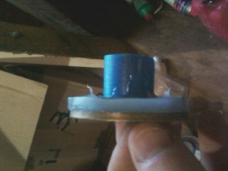

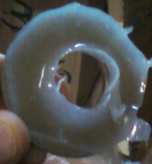

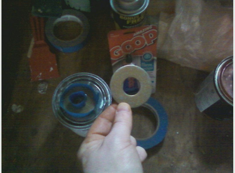

If you want to build your own gasket, get some "goop" from Lowes and make a masking tape damn around the washer. Then fill it in with goop and let it dry over night. I've done this... it works great. See pics.
