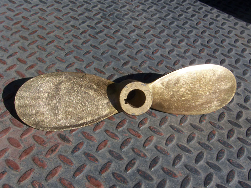

I sailed under jib alone up the Miles River and around Tilghman Point. Reaching down towards St. Michaels I suddenly felt and heard a bang. I thought for an instant I had run aground but the sounder showed over 20 feet. There was nothing visible in the water. Maybe it was just a wave catching the counter just right but I’ve never felt one like that before.
I started the engine about a mile later and noticed that there a bit more vibration than usual. I’d just started thinking about it when there was a very loud crash and the engine started vibrating wildly. I shut down and checked what I could see inside and for any stuffing box leakage but everything looked fine except for a jacket drain hose that had fallen off the engine from the shaking.
I started the engine again and cautiously brought up the power. It felt exactly like when I’ve picked up a big snarl of rope, heavy vibration and about a quarter the normal power for any RPM. I sailed as close as I could and motored the last quarter mile at idle which kept the vibration just below alarming.
I’ve needed to get new shaft zincs installed anyway so I decided to let a diver clear the prop. The first one I called was sick but gave me the name of another. He was still in his wet suit from another job and just 15 minutes away so standing at the town dock to help me tie up when I limped over from the anchorage.
The diver went down, came right back up, and said, “Have you got a spare prop?”
I was stunned. I never would have believed a one bladed prop could propel a boat even that well. The strains on the strut and shaft must have been enormous. If this had happened 5-10 miles out and I had thought I was just dealing with a rope snarl, I hate to think what might have happened. I’ve limped to a harbor with those before.
I called H&H Propeller to have them look up the diameter and pitch and asked about delivery time in case I couldn’t find a prop locally. Five weeks.
Kastel Brothers just down the road have one in stock and just need a day to re-pitch and machine it. The pilot bore is for a larger shaft but they will put a nylon bushing in it intended for that use. The bushing will be a little more forgiving than metal so the prop won’t need to be lapped to the shaft and the diver will be able to put it back on. I should be underway again by the end of the week.
I’m now tied to the St. Michaels Marina dock. The diver and I were able to just pull the boat 100 feet down the pier that the marina shares with the town dock and I’m all set for the next few days in one of the nicest places on the Chesapeake to be stuck. I’ve been wondering when I could commit to being in one place long enough to refinish my wheel before all that beautiful rope work gets too worn so that conundrum is solved.
Thinking about some of the places this blade could have come off in the last few thousand miles gave me the idea for the title of this post.

Roger,
Your pictures look like you have both pieces of the prop? How is that possible? Do you agree with Mainesail on dezincification as the culprit? Does the broken area show signs of metal fatigue as noted by a crack propagating or other type of failure? How common is this failure in sailboats? What are the signs of zinc depletion so it can be inspected during haulouts?
Nov 22, 2008
3,562
Endeavour 32 Portland, Maine
Look closely, that other piece is a detail insert that I cut and pasted in. EVERYONE I've heard from thinks it's the other blade now resting somewhere in the Miles River.
The prop is original 1980 and had an electrical problem for years that I just tracked down the source of last spring when I discovered that the PO had used part of the bonding system for the (-) wire of the fuel pump.
The prop was reconditioned, re-pitched, and inspected last winter. The red area in the break doesn't run out onto the surface at all so I think there was probably a pre-existing crack or casting flaw that promoted corrosion in that area. I would think that straight corrosion would be more distributed on the surface. I've had the boat stopped under sail by pot warps fouling the blades.
I certainly did hit something though. The engine was running fine. I shut down to sail and hit something. There was slightly excessive vibration as soon as I restarted about 20 minutes later. I was just wondering what that cold be when the blade came off. It was clearly slightly bent after the impact.

Unless one has owned a prop since new nobody knows how many times it has been re-pitched. Nor indeed how many times the re-pitcher 'tweaked' each blade back and forth until he got it right.
Striking something whilst under way with enough force to seriously crack a 'normal' prop would be an eye watering, tooth jarring incident and would most likely bend the shaft in the process. One would certainly remember it very well and worry accordingly.
IMHO we must conclude the prop was already seriously weakened - and yet DZ effects normally work from the outside inwards and twisting to re-pitch likewise hardly affects the inner structure of the metal.
Tough luck Roger. Hope nothing else suffered e.g. shaft, cutless, log or 'P' bracket.
I would think so too but this prop has had a number of strains, stopping the boat under sail when snagging a pot wharp, chopping up lobster pots, chopping branches in the ICW, let alone whatever I don't know about between 1980 and 2005. The blade was clearly half to quarter strength when I hit something under sail a half hour or so before starting the engine. It probably would have gone a bit further if not for that, perhaps up to the tardy bridge I was just waiting for with a wind and strong current behind me:)
I just ran hard for 20 miles and everything feels rock solid. Boat is much smoother.
