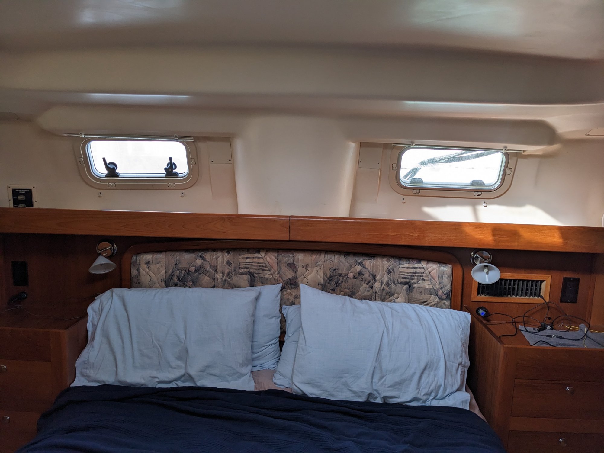

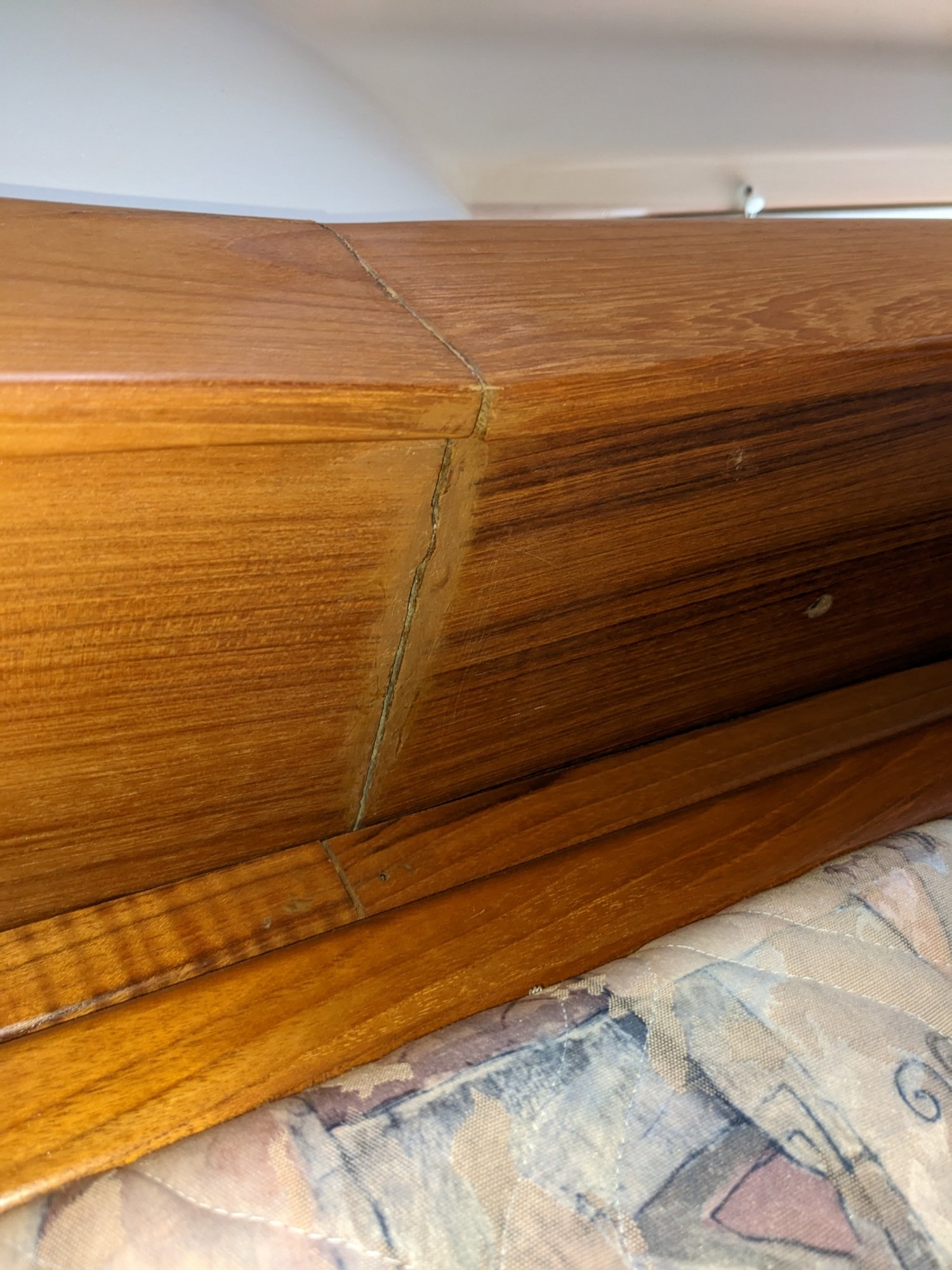

This is the shelf and you can see a gap between them here:
The shelf was attached in the middle.

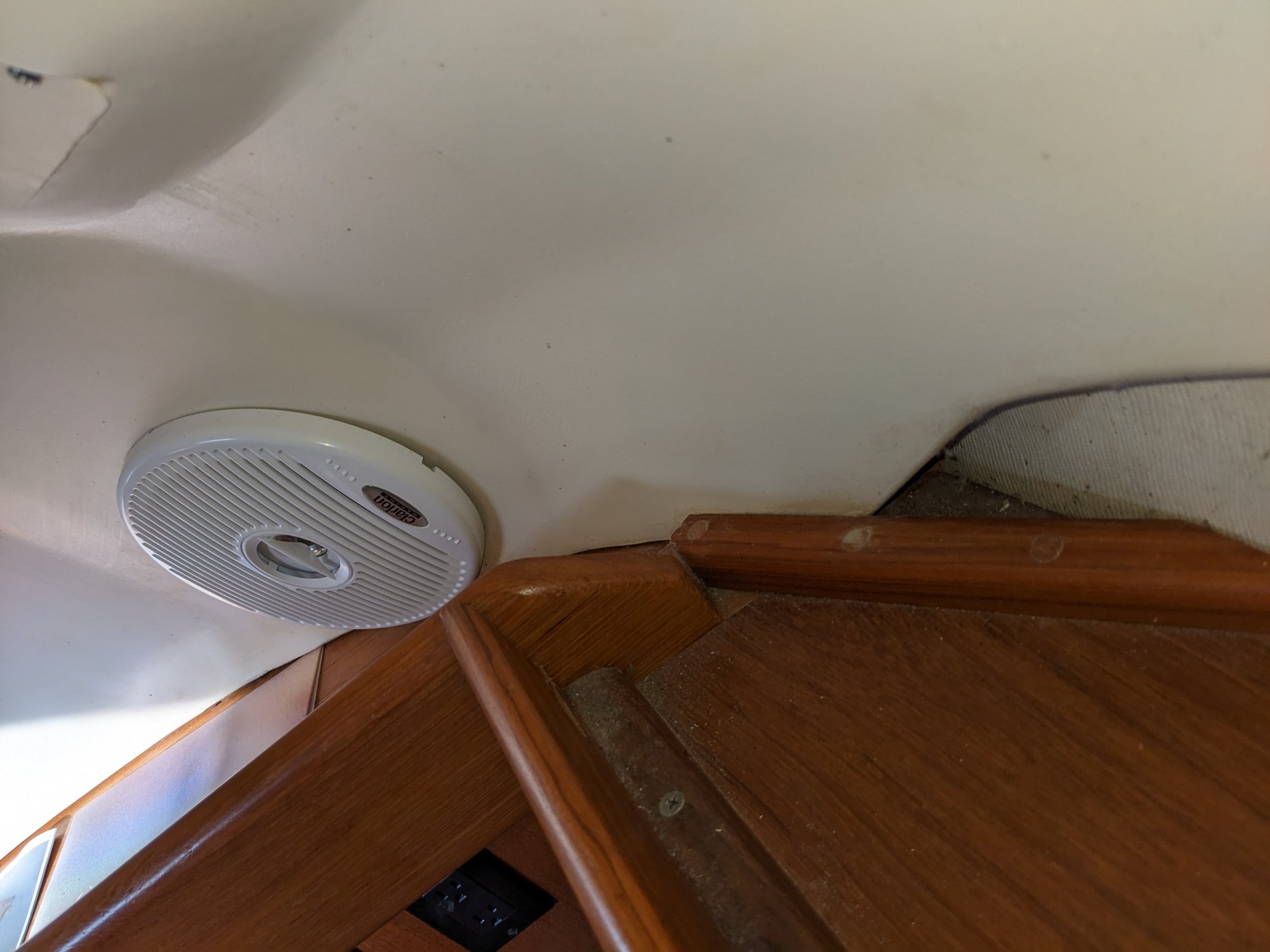

The creaking comes from the port corner:

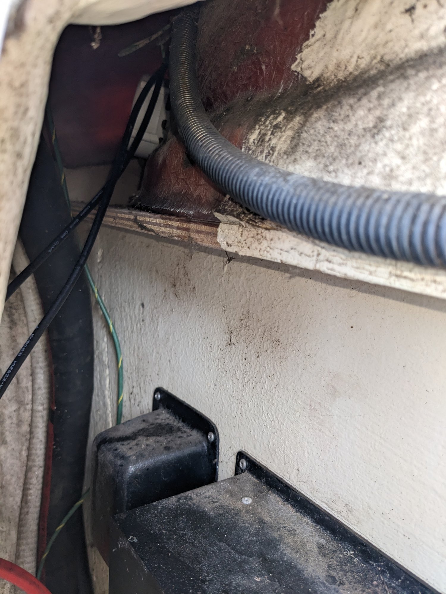

But based on the conversation I took a look at where it attached in the rear lazarette:
And when you zoom in above the plywood that is the shelf protruding through, you can see the fiberglass pulling away. I think I'll grind it out then re-glass it.
23,802
Certainly could not hurt. The thing no one tells you when you buy a fiberglass boat, they are constantly flexing as they react to the wind and water. You are identifying a normal result of boat age. I suspect you will resolve the issue. Be prepared for another such opportunity to appear about the same time you start to relax. The boat is just the way I want it.... :yikes:

So I glad in a filet below the shelf in the lazarette and that seems to have fixed it! Been through several rolly nights with no creaking.
