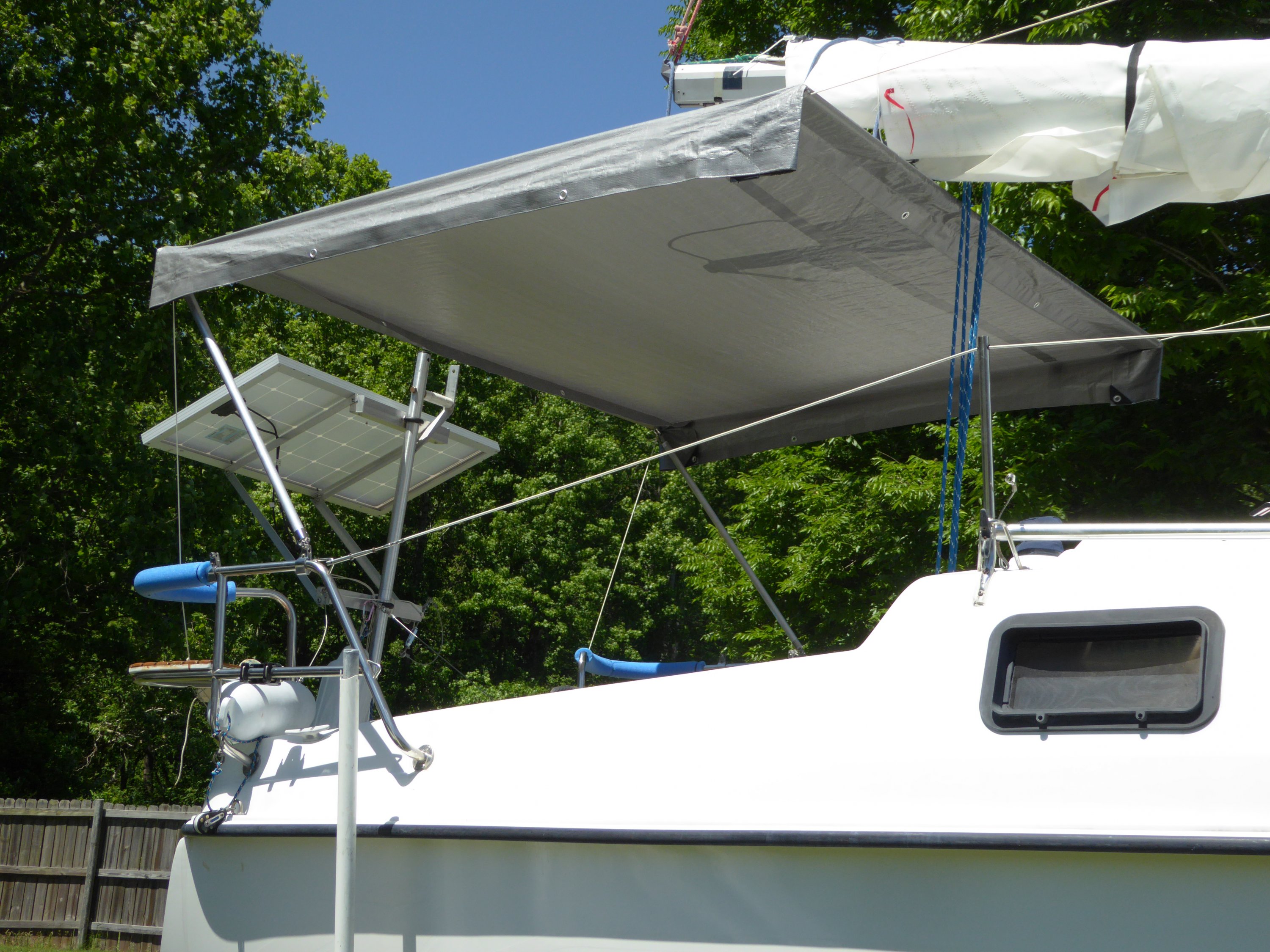

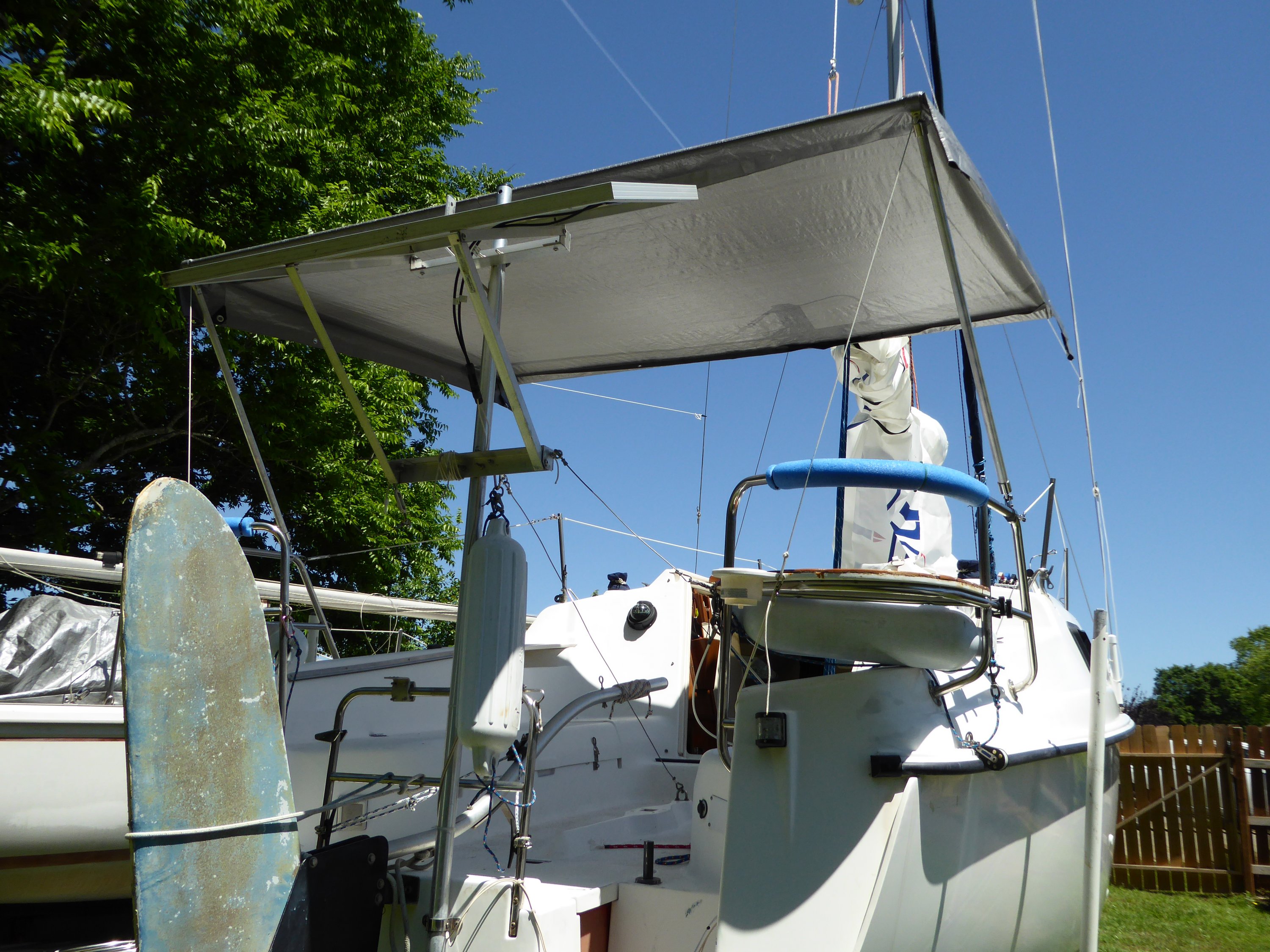

Here is my guetto awning and 3 reasons why it is better than the normal factory one. Reason 1. It sets up fast, clip 2 lines to side stays. 2. Unroll torwards back of boat. 3 unfold verticle poles. Slide 1 of the verticle poles into the socket and clip rear guy. 4 repeat with opposite side, done. 2 It stows easy for trailering, rolls into an 8 foot 3 inch thick bundle. 3. It provides more shade. 4. It can be used to collect rainwater to fill onboard 25 gallon tank. 5. It can ...be stored wet and will not mildew and 6. It is very cheap to replace. The only negative, IT LOOKS GUETTO. It is OK to laugh at my awning. I'll be in some beautiful place, sipping on a cold one, watching the sun go down, minus a really bad sunburn. I hated the factory awning because it had to come off for trailering, was heavy and bulky to stow and handle and was a pain to set back up. I will only install it if the boat is left at a marina for a long period.

Take the set screw out of the lower pole bimini socket and you can just leave the bimini socket attached with the screw at take down. The downward pressure from the rear lines keep it in place. Just pull the pole out for quick take down. Easy to make bimini. Fold the ends over, sew with 4 lb test fishing line, insert pole in each end.

They clear the main sheet. With this fractional swept back rig, the mainsail will contact the spreader before the mainsheet touches the awning line. I have used the same set up om my Catalina 22 for over 15 years with no problems. I think if the mast support pole is higher like the 260 is, I could just fold it back. When folded back it also was up against the pole and blocks my panel. I just grew to hate the thing. Check out my kite aerial. Awning is always in my way. I like the clean look with it gone. I just have used my homemade awning so long I like it better. I was going to make it with sunbrella fabric originally. I used the tarp as a pre test sort of thing. I liked the ability to fold it up wet with no worries. It also lasted for years since it was only exposed during my trips. So I never bothered with Sunbrella. When removed it is completely out of the way. If I don't want it in the cabin, I stow it along the starboard stanchions. I am going to sew a flap on the forward edge that can be unrolled to cover the entire companionway hatch. A small rope tied through the 2 grommets like reefing bunt ties will hold it in the rolled up position. Should keep the cabin cooler inside. Towels can be hung to the side flaps to block sun from the sides. I bought some small Harbor Freight hand clamps to hold them on. I also want to make an anchor riding sail sometime this summer out of an old C22 sail. Projects are part of the fun for me. Guess you just got to use what works for you.
