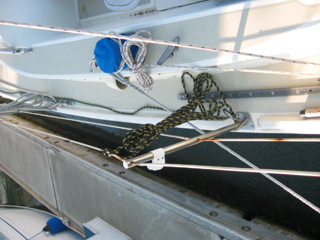

Francois, Here is a photo of my genoa rail... or I should say rails.My rail is not continuous like yours appears to be. I have a block on the front rail and a block on the back rail. I would not cut your rail wothout installing a proper rail end fitting or you might cause the end of the rail to bend upward as the block pulls on it.
