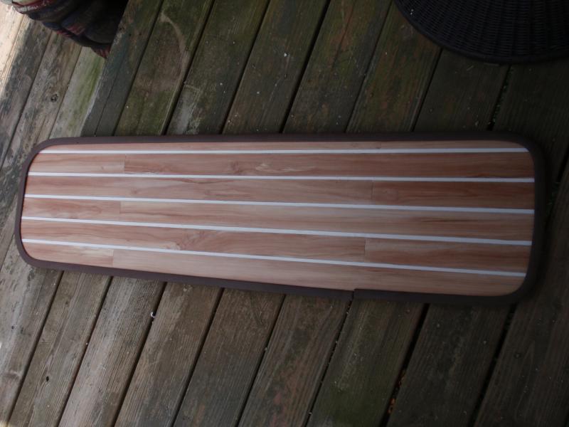

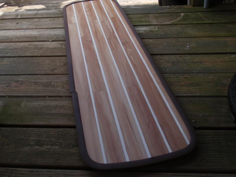

Thought I would post a couple pics of the faux teak/holly floor I will be putting in. I thought I would start with the bilge cover to work out the kinks first. The vinyl is 4" wide x 36" long maple from Lowes that has been cut to 2" wide. The holly is almond silicone. I am quite pleased so far. Just had some "lessons learned" with the silicon. I tend to mess with stuff too much to make it perfect and end up screwing it up. When I install the floor, I will lay a bead of silicon, run a putty knife over top and LEAVE IT ALONE until it dries :) It comes off easy on the vinyl.

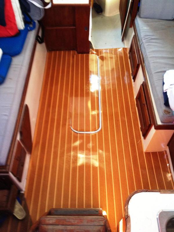

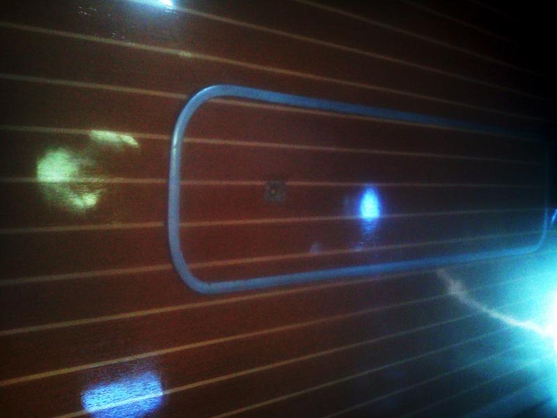

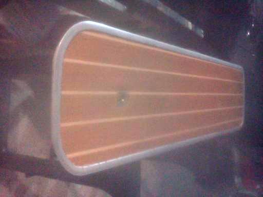

Take a look at this. cut cardboard pattern on the floor and then transferred to the PlasTEAK and cut with sharp blade (new) on utility knife. Used cut-out portion for the bilge cover. Marked trim in pencil for the stripes and took home to work on and get it right. This was installed on '79 Hunter 30'.
