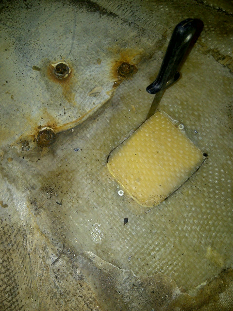

I put the access plate there.:D Because I wanted to Goop the antenna to the inside of hull for the hummingbird in that location. Weep holes in the wood stiffeners was so any water under the v-birth and on top of the water ballast tank can then flow to the port or the starboard bilge.:clap:
BTW....I used 3M 5200 hundred to glue the wood stiffeners down...:eek:
The 5200 worked good for gluing down the boards huh??
