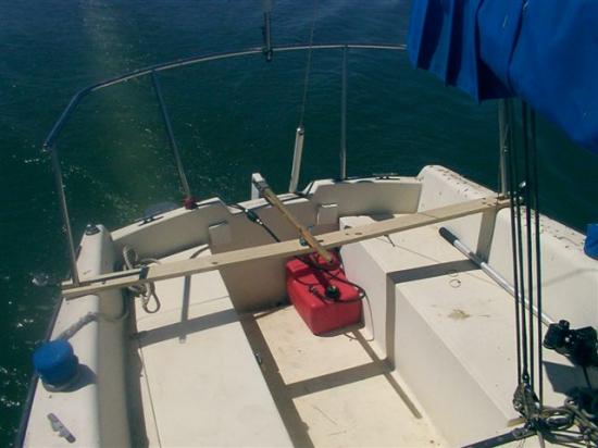

Here is a pic of a tiller tamer that I designed myself for about $6 and it works great!! I tried the Davis one from WM ($40) and the Canadian one ($20)which lost it's tension after one season. I constructed this one out of one piece of pine/a spring loaded holder/ and a hinge (unseen on the bottom.... it folds up to about 3 feet for easy stowage). Has anyone else had sucess building a DIY unit? If anyone needs additional info or pix: kennybc22@sbcglobal.net

Piece of cotton line w/one loop around the tiller, shock cord on each end of the line. The cotton line has enough friction to hold the tiller where I want it for a couple minutes, but still allows me to handle the tiller. Oh yeah ... my "folds up" too :) Tom Monroe Carlyle Lake

a 6 foot piece of rope with a loop in the middle that fits over the tiller, the ends are run to small clam/jam cleats on the coaming. I've never folded it up, though, just throw it in the coaming box.

MG......... Thanks for the reply..... but the Cansail site is the Canadian product that only lasted 1 season that I wrote about. The tension on that unit just gave out. I would not recommend that anyone waste $$ on that.
