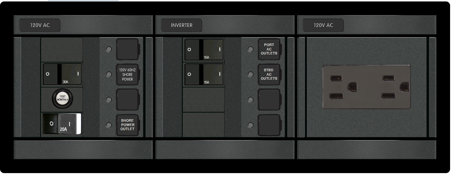

Blue Sea's 360 modular panel system is very nice. I used a 1x3 frame and setup for my AC panel.

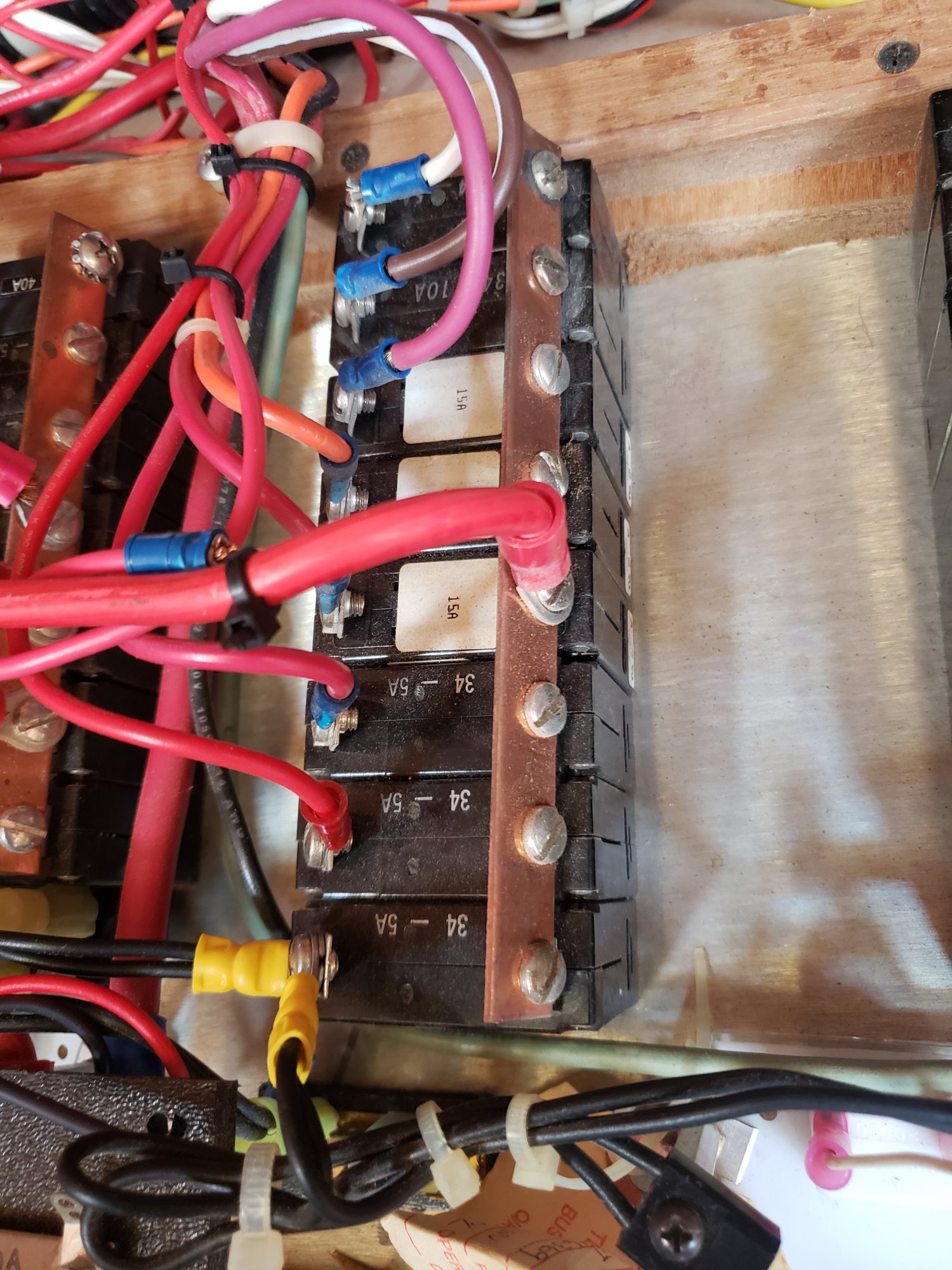

Follow up: yes, confirmed. On mine, because of the way the plus bus is attached to the breakers, one would have to pull all the breakers from the panel to get one out, or remove the plus bus from all the breakers. Take your pick. :(

So, if you unscrew the bus screw, and the + wire, the breaker doesn’t snap out ( to the left in this photo)?
It just seems crazy that you would have to remove them all to upgrade or replace one…
Do you have any open slots?
Greg
13,456
No, just remove the mounting screws on the front of the panel and the breaker should tip out the back.

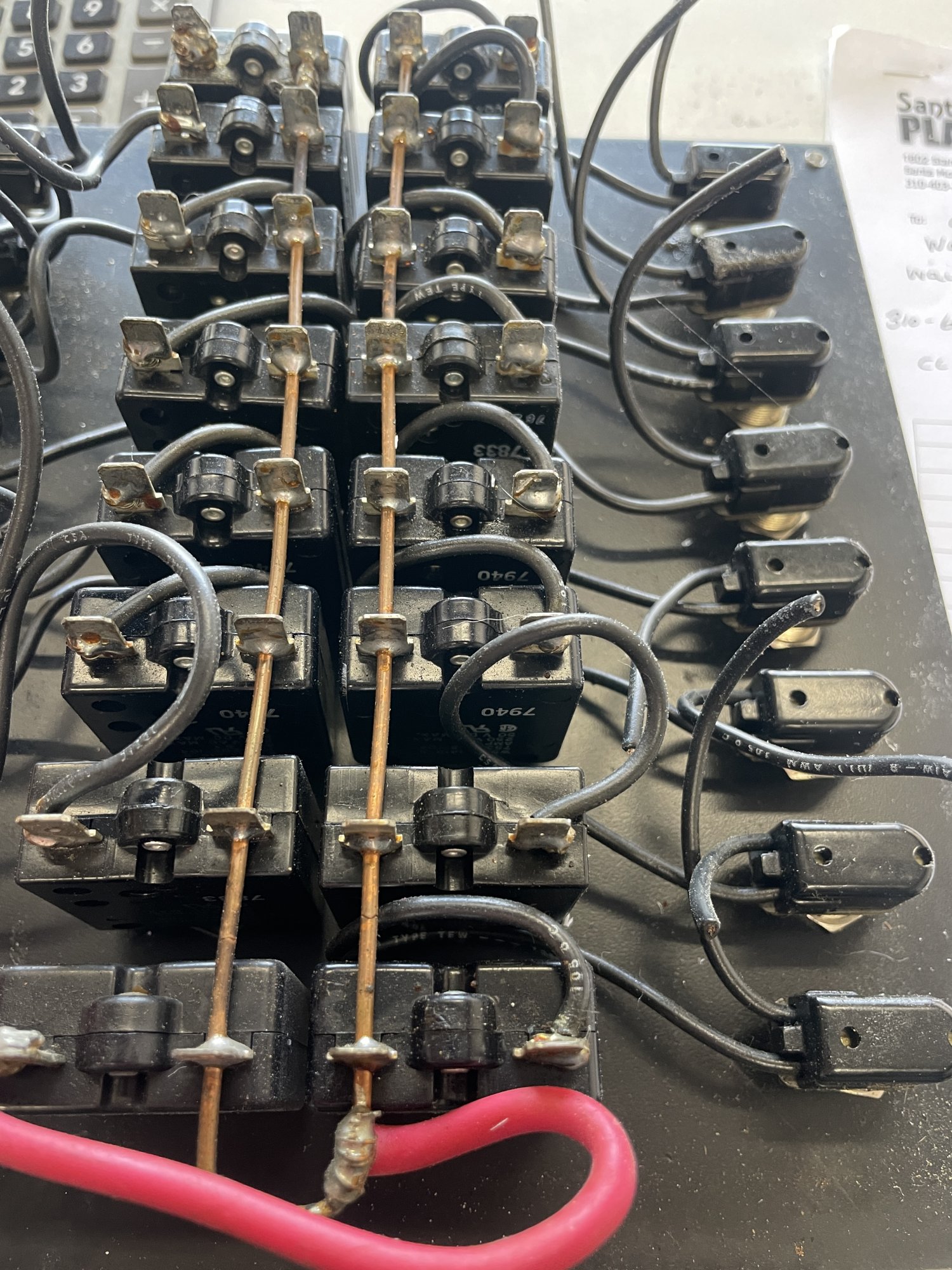

On my original panel they soldered a copper rod across the back of all the breakers. I cant tell if they also drilled holes and soldered the rod through the holes or not. I never bothered to try and remove any and just built a new panel.
