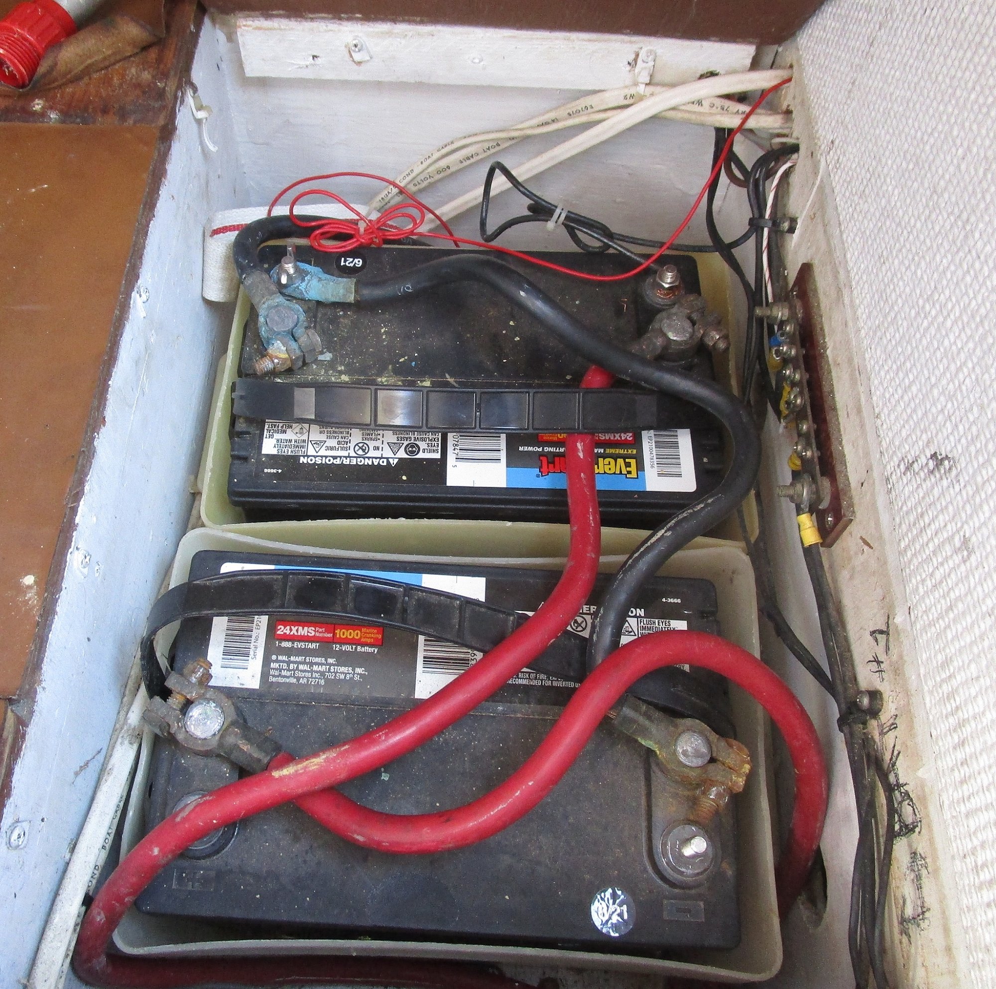

  • The alternator was replaced a couple years ago according to the PO. The nameplate was pretty dinged up so I couldn't read much of the details but I did find a part number printed on the frame (12108N) which matched up with Yanmar's part number for the OEM alternator. It is rated at 35A so that's what I am assuming this is.
  • The battery cables were laying in the battery box (unsealed but painted) with very little clearance for ventilation. The boat had two group 24 batteries (not installed at the time) connected to the traditional 1/2/B switch and the negative terminals jumpered and connected to the engine ground. The negative cables had 1/0 (105C) printed on them but none of the positive cables have any markings and visually appear to be larger than the 1/0 cable. Since the insulation had pulled back from the lugs, I tried to measure the OD of the actual wiring but, since they had been flexed so much and with a little corrosion, it came out somewhere between 1/0 and 4/0 depending on the angle I measured it.

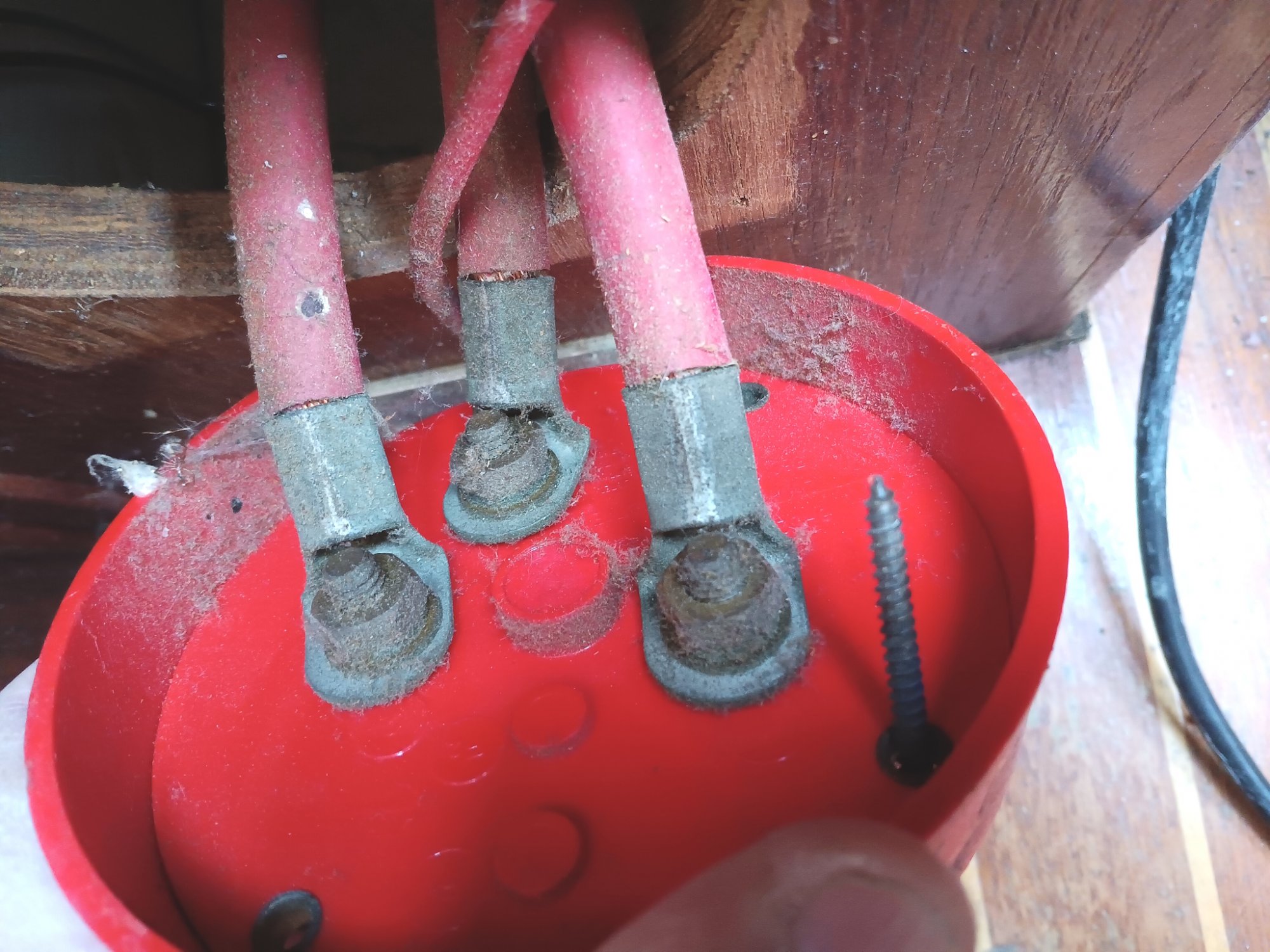

  • The 1/2/B switch terminals were all tight but the connections had corrosion all around them. The switch had no markings on which terminal is which nor any manufacturer information.
  • Inside the battery box was an ancient, exposed ground bus bar with all the positions filled.
  • There were no fuses anywhere except the DC distribution panel.
  • Thankfully, the PO took the batteries home and kept them on a trickle charger over then winter until I had access to the boat again. When he brought them to me, I was shocked to see 2 Walmart G24 sealed lead acid "deep cycle" batteries. Dates on them were 2021. I do have a picture with them installed from the survey but didn't think to check it first.
  • Nothing is labeled.
Here are a couple pictures:

Get some Boeshield T9 - it is excellent to help clean up electrical connectors and keep them in good shape.
I would not invest in lead acid batteries at this stage. LiFePo batteries are the only way to go for house batteries. Start battery can certainly be lead acid but lead acid house batteries are just not in the game anymore from any perspective.
It's not clear to me why you would change the current battery cables. There is nothing in the pictures you attached that screams "change these cables" but I'm not at your boat. Looks more to me like get a stainless steel brush and some T9 and clean up some ends. Am I missing something?

Why do you have a black (negative?) wire connected to the positive post of the battery in top of pic? Is that an optical illusion or just repurposed black wire?
13,266
The batteries are not oriented in the same direction. One battery has DC+ on the right, the other on the left.
Nov 6, 2020
487
Mariner 36 California
I see that but the top battery has red pos+ wire on right side stud. There is a black wire right behind it wrapped around the pos+ threaded stud. I'm assuming PO just repurposed some black wire otherwise i'd assume there would be some pretty obvious problems going on with the electrical but maybe worth checking out if OP is not 100% certain.
13,266
Oh, that 10 ga (?) black wire. That's wrong in many ways even if it was a repurposed DC+ wire. @TrapperJohn needs to get rid of it.

I agree with @mermike about replacing the 1+2+B switch with a DCP switch (especially if you plan to use an ACR - the 1+2+B switch is a dinosaur that was made when charging relays weren't available) if you are going to replace your switch. It's a much better choice. The only negative is that you should install 2 On-Off switches so that you can isolate the banks in an emergency (the switches should be hidden so they aren't inadvertently messed with). DCP is uncomplicated and separates the house and start banks while they can both be used simultaneously. I can't think of any reason to even install an ACR with a 1+2+B switch since the purpose of the switch is to selectively charge batteries together on the B setting or individually depending on the 1 or 2 setting. It's a stupid switch for today's methodology.
Well, assuming that it is a ground for something, it should go to a NEG buss bar at least. (oops - now I see that it is on the + post!) Make sure you track that one down! BTW, trickle chargers suck! Don't continue to charge your batts with one. Chronically undercharged batteries die an early death.
