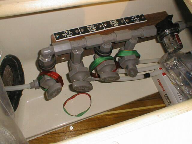

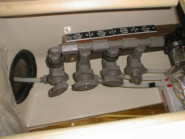

JohnEh - you haven't asked, but I will give you an easy way to keep track of which tank you are using, which tanks are empty or full, and in what order you might want to drain them.
I expect that you have a water manifold with three valves. Open one and keep the others closed. I have four tanks on my h40.5 and I devised a simple method to code the tanks. Rather than trying to remember (which hardly ever works well 'cause I'm old), I sewed some rings of red and green lightweight webbing or ribbon. Green on one side and red on the other. A band with the green side out means the tank is full. And red side out means the tank is empty. No band on a valve indicates the tank currently in use. And if you use the tanks in the order of the manifold valves you will know which one to use next. As you change tanks, just flip the band inside-out.
Also when you refill, you can look and quickly determine which tanks need to be filled.
So easy a caveman could do it.
View attachment 177847View attachment 177848
Awesome, thanks for sharing. I have 5 tanks on a 460 that I just purchased. This will work well, I might use electrical tape instead, since I can't sew !!
