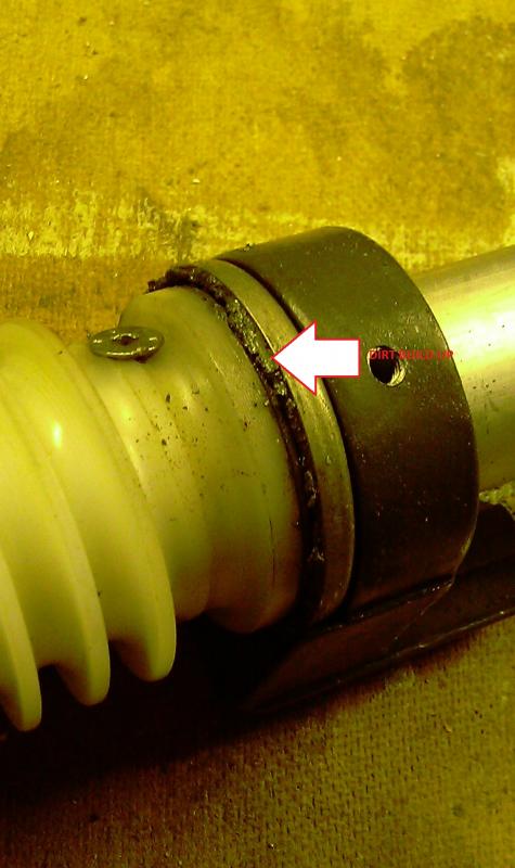

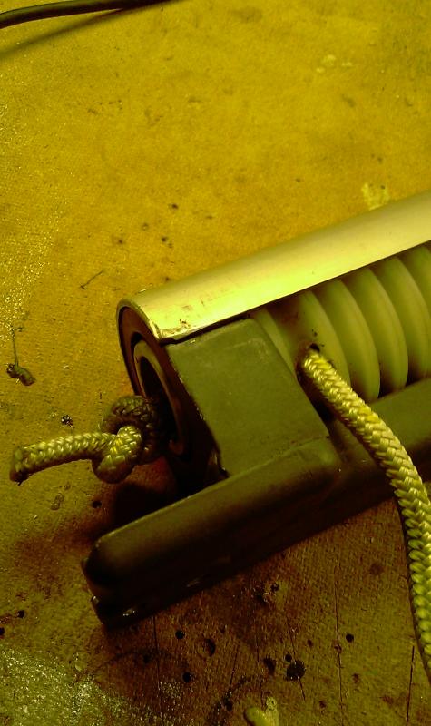

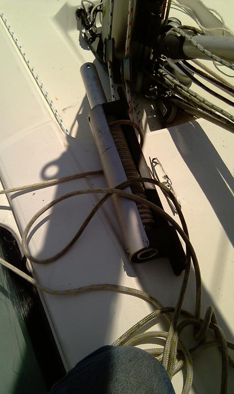

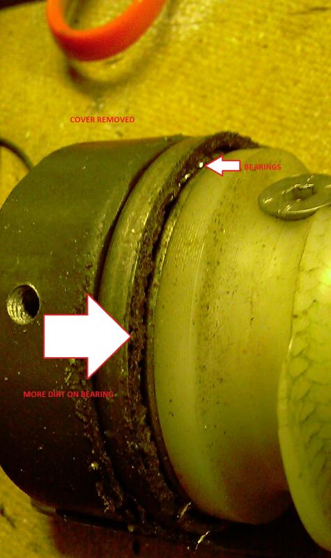

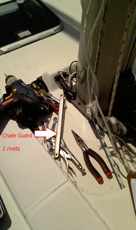

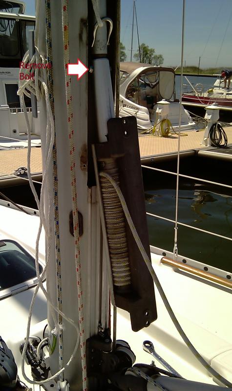

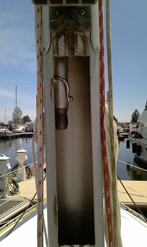

If your's is the same as mine, I have attached some pictures to show what is involved. Z-Spars also has a write-up somewhere.
One thing to watch for is when you dis-assemble the unit , don't lose any of the bearings. They will fall out and roll away:doh:
