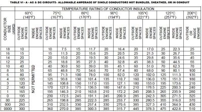

Each battery bank should have a fuse within 7 inches of the battery terminal. If the house bank has 3 batteries wired in parallel, then there is only fuse at the positive end of the bank. In your case you would need 2, one for the start battery and one for the house bank. Yes, ABYC does not require a fuse for the starting battery, nonetheless it is a good idea and so long as the fuse is large enough ~250amps there should not be a problem with it blowing.
The instructions for an ACR also give some information on wire sizes and fuses.
The fuse size is based on the cable size. Look at an ampacity chart and then size the fuse to the cable. Here are a couple of charts:

The double MRBF terminal post seems to be a good fit for me, for each bank. I have 2/0 AWG 75C Battery Cables from the switch to the batteries. The distance from the ACR is about 2 feet to each positive terminal.
And the double holder will let me use a 100 AMP Fuse for an ACR and a 170 AMP Fuse for each Bank.
