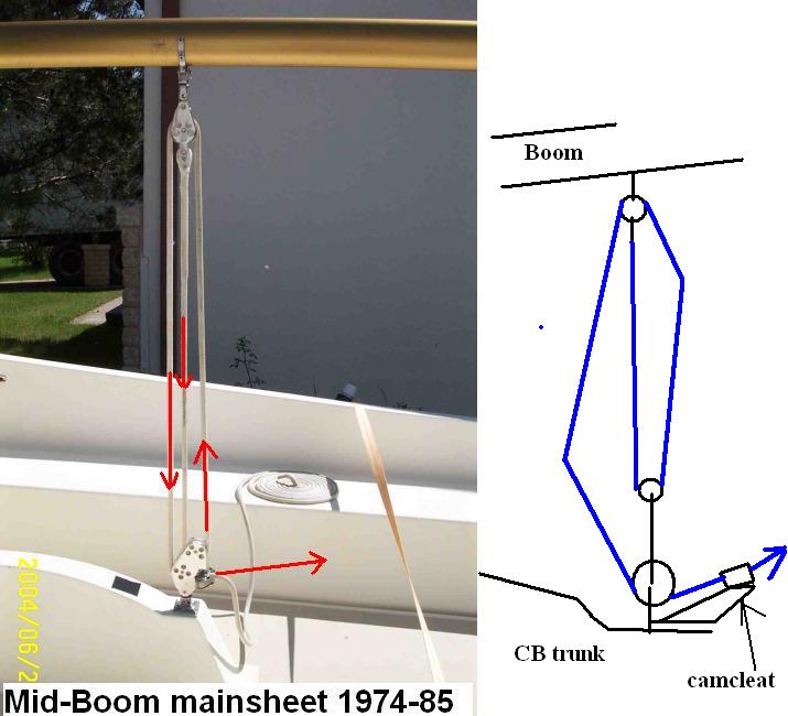

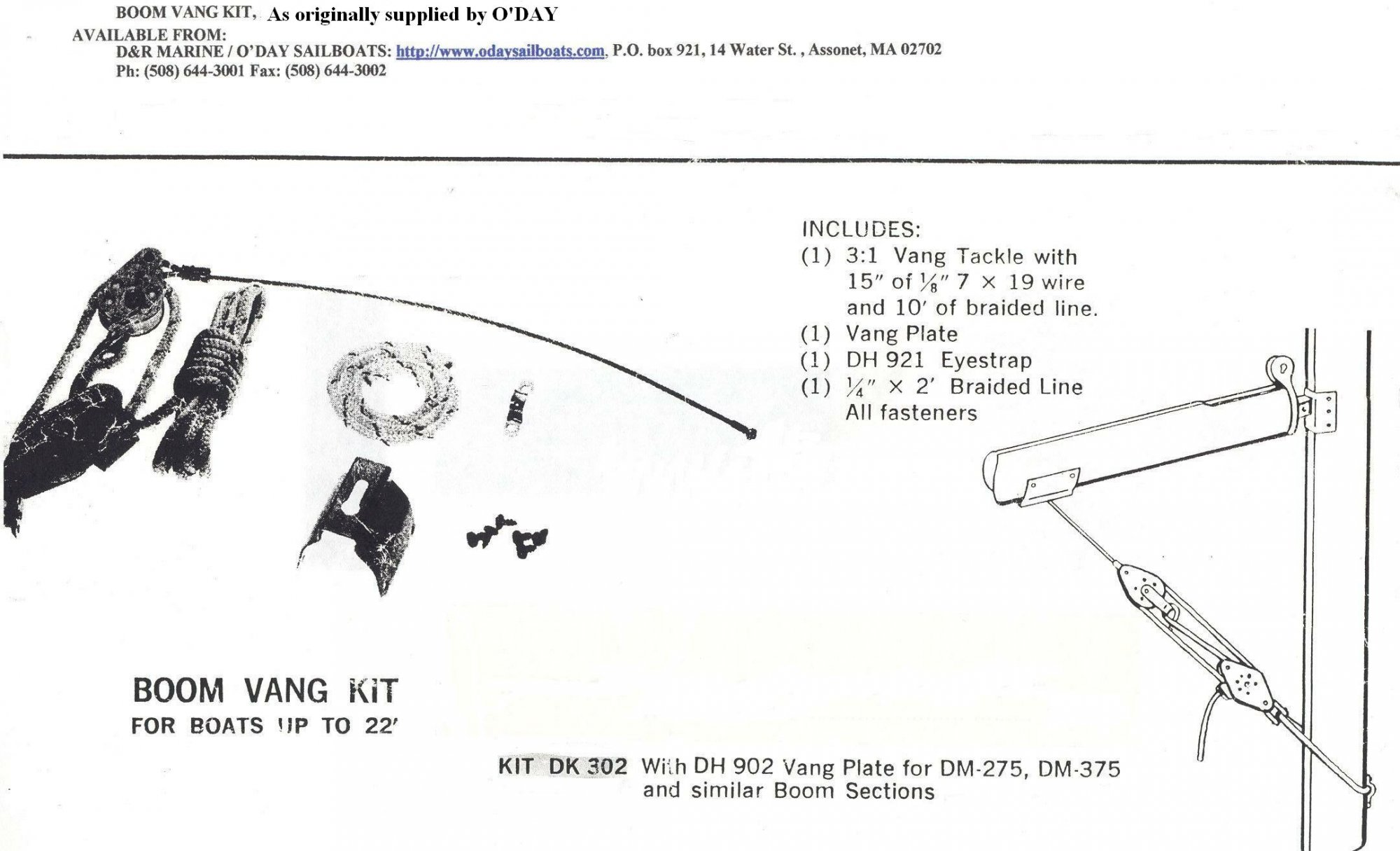

Hi all - just found this old thread and hoping someone responds - I'm actually looking to do the opposite. I have crosby rig on my javelin '14 (a 1968) as per original owners manual but finding it interferes somewhat with the motor I need to push in and out of where I tie up. I want to move to mid-boom sheeting (I've seen many pictures online) but can't figure out what hardware I need on the boom and on the centerboard housing to make that switch. I am also curious whether mid-boom requires a boom vang. My boat has a notch to attach a boom vang at the bottom of the mast, under the deck - that seems confusing, how would it allow the boom to swing if it's at all tensed?

Mid-boom sheeting will not "require" a boom-vang.....BUT IT SURE HELPS! <GRIN!> The vang is a big help even with the original mainsheet setup, I had more or less that setup on my old O'DAY Widgeon (12' sloop), and the boom-vang made a big difference! It holds the boom down so much more of the mainsheet "pull" is adjusting hte side-to-side postion of hte boom/sail, very little goes to pulling boom down, making less work to pull in the sheet.
My current boat is a 1979 DS II, and she has the newer mid-boom mainsheet. You will need to replace the block on the aft end of the Centerboard trunk with a "fiddle-block" (2-sheaves, one above the other) and with an integral cam cleat, Remove the blocks on the boom, and install a boom "bail" (really a loop of metal hanging down from boom) (I can take a pic of mine if it would be clearer than the picture below), on this you will attach a single-block that can swivel side-ro-side and that has a becket intalled (strap to attach end of mainsheet to ,see pic below). The below pic should explain routing of line and basically what blocks are needed. Javelin and DS II used pretty much the same mainsheet for the mid-boom rig. Boom-Vang was same too. Actually, I might suggest calling Rudy at D&R Marine (508) 644-3001 to inquire about parts to change your mainsheet, he used to work for O'DAY and now runs a little shop supplying parts to O'DAY Owners. He sells blocks and will know just what to suggest.

Thanks Sunbird!! Just saw your other reply to my other question on the other thread, and then I saw this one! YES! This is exactly what I'm looking for. This is perfect. And thanks for the tip on calling D&R - I've perused their website a little bit. Really appreciate it. This looks like the next project!
If the boom vang attaches to the mast above deck, I wonder what that metal loop is at the base of the mast below deck....
