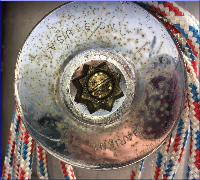

Hello all,
I have old Barient 9's on the mast and would like to move one to the cabin top along with line clutches to make halyard handling easier when solo-sailing. It's not pretty but works fine.
I can't find the manual on L-36 (or Google) for the No. 9. The center screw is loose but I"m concerned that if I pull the drum "bits and pieces" will fall out since I have never worked on winches. Is this a risk with this winch?
My plan is to mount stand-up blocks on the mast base using SS machine screws and taped holes I will drill for the block bases. Then route the lines through a deck organizer and back through a Spinlock clutch. The Barient will be mounted behind the clutch.
Comments about pulling the winch are desired. Thoughts on the re-routing of halyards for solo-sailing welcome.

I have several Barient winches, some 17’s Self Tailing on the mast. I feel there are advantages to go to the mast.
Regarding the winch and service to it, there are several ways to safely open the winch. You can wrap a sheet around the mast and dress it out under the winch and fold it into a cardboard box beneath the winch.
I would follow the general procedure for cleaning and lubing the winch. When you get the outer cover off the winch. You should be able to pull the gears out by rotating the pins holding them and removing them.
take a picture-if you get stuck. I’ve been successful with them.

Now to winch servicing.
You will find lots of vids on youtube,
I think these have the bearings in a cage so you wont end up with lots of bearing needles on the deck.
Have someone hold a decent plastic bag under the winch as you remove it just it case.
Drop the parts in a bucket and wash with whatever you like (paraffin, diesel fuel etc).
Reassemble with light grease on the bearings and oil on the pawls.
You will be surprised at how easy it is.
