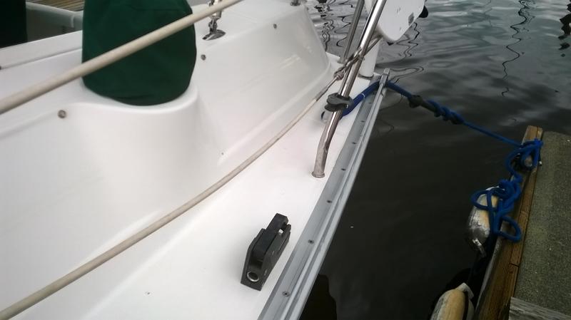

I did this a year ago on our 361, I'll get some pictures if you want. I went with same leads as jackdaw but had a spare Spinlock clutch that I mounted as far back as I could on port side, took me a while to stop stomping my toe on it. Then I have a block on the stanchion so I can take it up to the coach roof winch if I have to, and I've had to....
I did it mainly because people, not me, were tripping on it on the bow and we carry our inflatable on deck, the furling would be under and rub on the inflatable. I always remove the line from the clutch and hang it before the gate on lifelines, otherwise the big gate has a nice trip line and as you can tell me and those I sail with are klutses.....

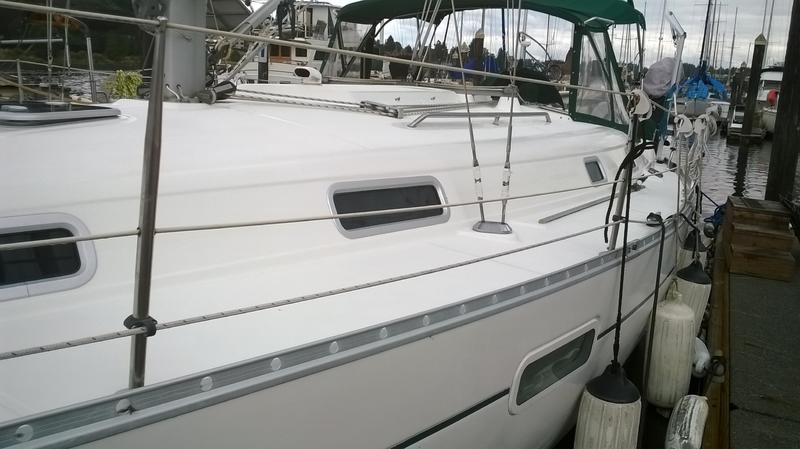

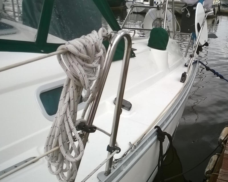

I actually lifted them up on the stanchion a bit and decided to put a cleat on the stanchion before the lifeline gate, where I hang the furling line when not sailing. When installed low on deck I found it would sag, slow down draining along toe rail and leaving lots of dirt. I live in Seattle area so proper drainage flow is important in the winter.
See pictures for our 361, used it for a couple of years, I like that I can pull it in with winch if needed. The only issue is the small block on the stanchion right after the rope clutch. I might replace it with a more free hanging block as the angle changes between winches and just pulling on it manually but there are many other things on my list before doing that.

That was a concern for me too and originally I had the lines on the inside. It really hasn't made any difference but I found that having them on the inside made the lines cut thru the deck more than if they were on the outside. Also the stanchions are angled out so the line is still "inside" the top lifeline.
Honestly not much difference, I tried inside then outside and preferred this and not had any issues with it.
