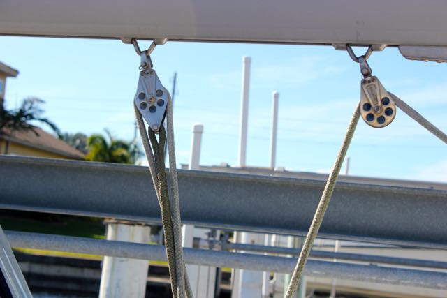

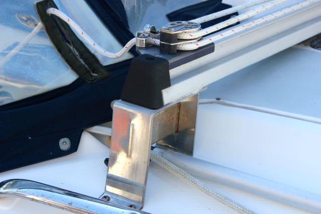

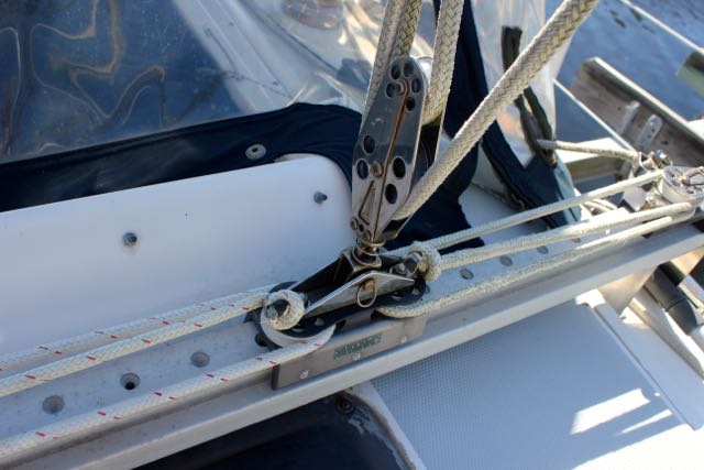

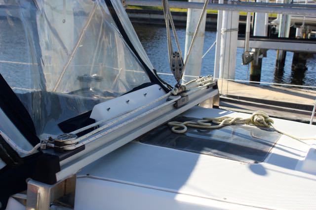

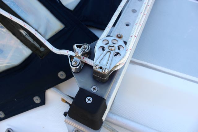

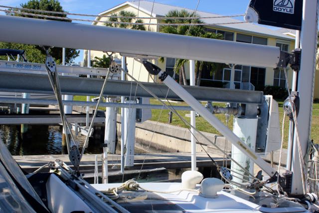

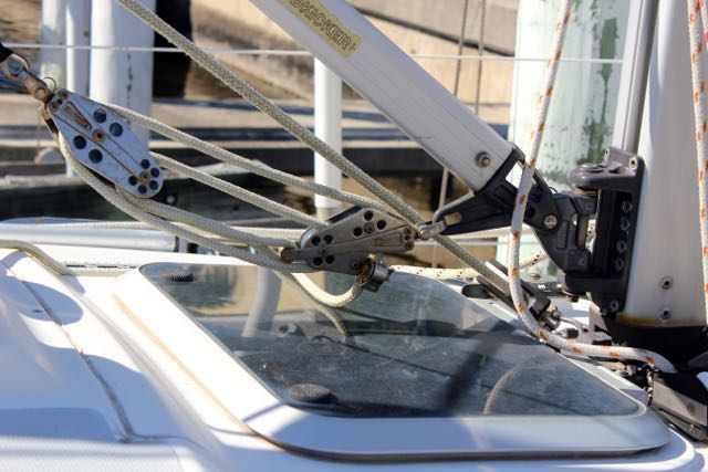

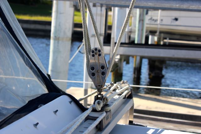

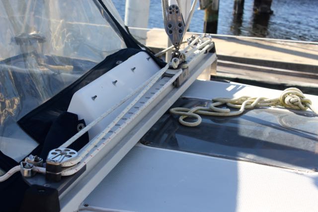

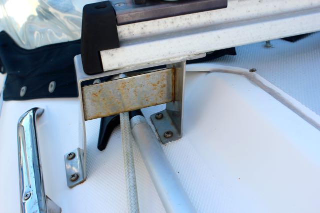

I have no idea who the supplier was. I am the second owner and I think this was an OEM from Hunter. Hope these help.
Mar 20, 2014
16
Hunter 29.5 Mandeville
Many thanks for the very helpful photos. They'll help me and others who may be considering the same modification.
Those short risers could clearly be fabricated by a local shop. Garhauer's catalog and website also notes that they can do custom riser heights for only $40 extra, which is tempting because their risers look pretty good.
