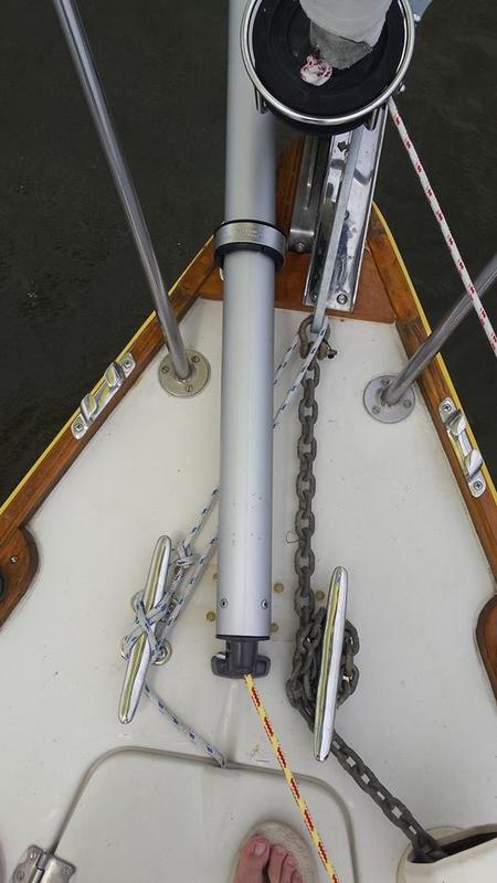

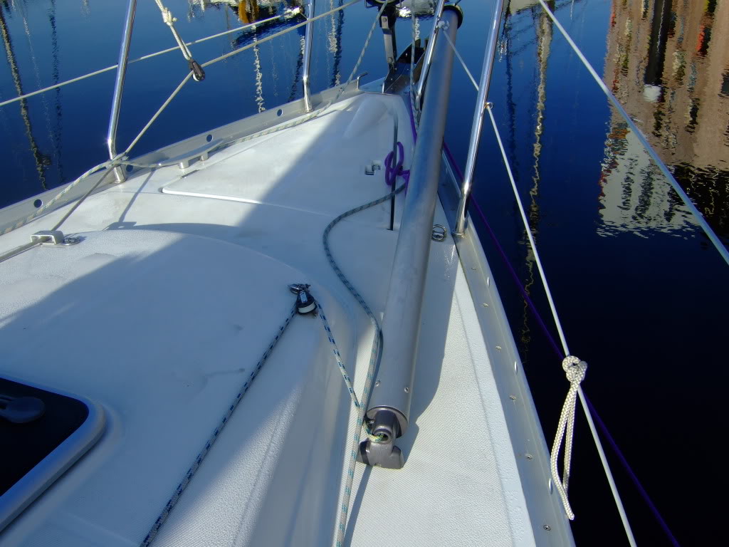

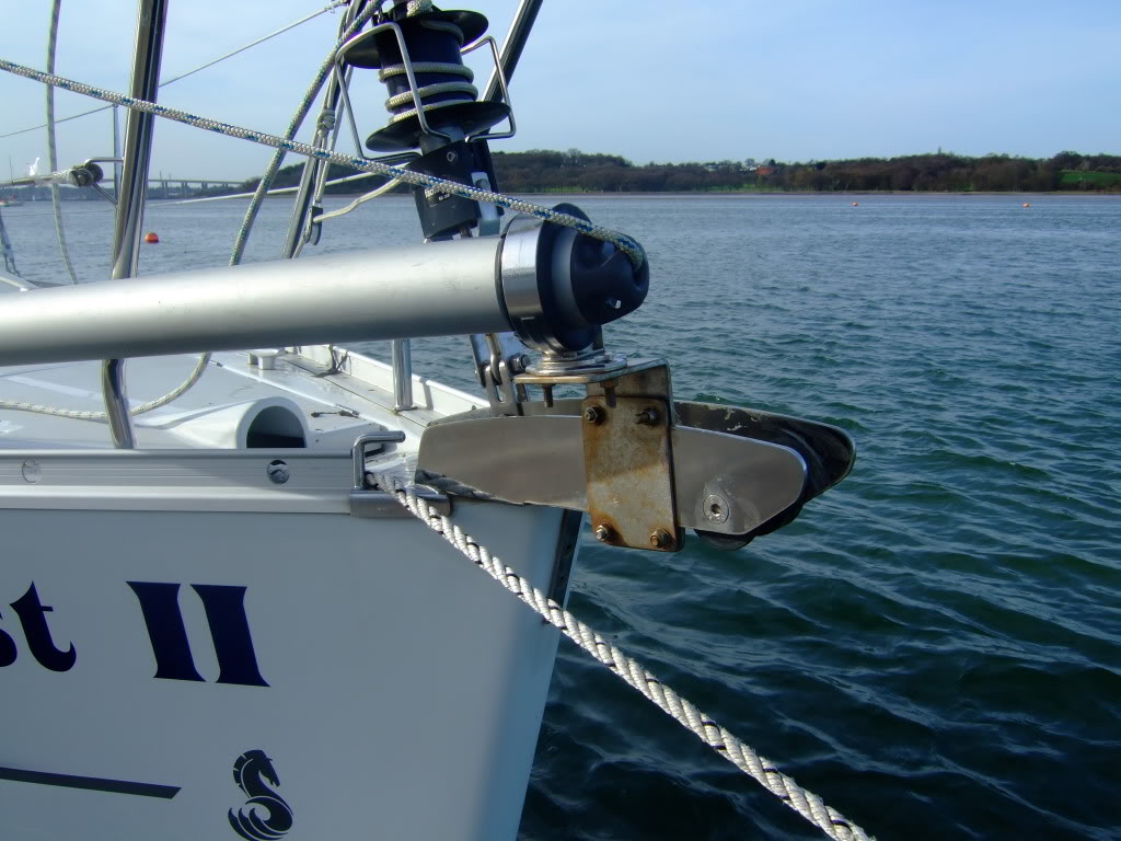

Thanks for your suggestions. Today I found someone who is installing a Selden 75/76 bowsprit on his Catalina 30'. He has proved most helpful. He suggested a custom made bracket mounted to the roller furler. I plan to have an L-shaped bracket that will bolt onto the anchor roller. The bow ring for the Selden will be bolted to this bracket. I attach several images of the proposed mounting (using a whisker pole as a substitute for a not-yet-purchased bowsprit).
I would appreciate (all of ) your reaction(s) to my tentative solution.

Yep, thats the way to sort it out.
Any chance you can get inside the forward pulpit post? That would be better for a bunch of reasons.

This idea came from a discussion group on the internet (pics attached). It sounded weird to me too, but, the more I tried other solutions, the more attractive it became as an alternative. The main problem is that the hump of the cabin roof does not permit mounting of the bowsprit near the center line. That said, the crowed foredeck combined with a 3" diameter pole that needed to be squeezed in made alternatives along either side of the centerline (including the one that I am leaning toward) more attractive.

I mounted a Selden sprit on my old Pearson 32. Let me just say that any type of bracket or modification that you use has got to be really stout. You will be astonished at the strain you put on it when the chute collapses then refills explosively in a breeze.

new323ownerView attachment 130323
When that pole is extended, where does the after end of it attach?
There should be a deadeye attachment point mounted on the foredeck at the point where the after end of the sprit would be at full extension. Probably a duplicate of the attachment point where the aft end would be when retracted.
The vertical loading on the after end of the sprit will be in the downward direction.

I do not have a second mount point for when the pole is retracted. I just remove it and store it in a cockpit locker.
22,746
Doug, In addition to the vertical there is also considerable fore/aft vectors and port/starboard pressures on the end of the sprit. The further the sprit is extended the greater the forces.
