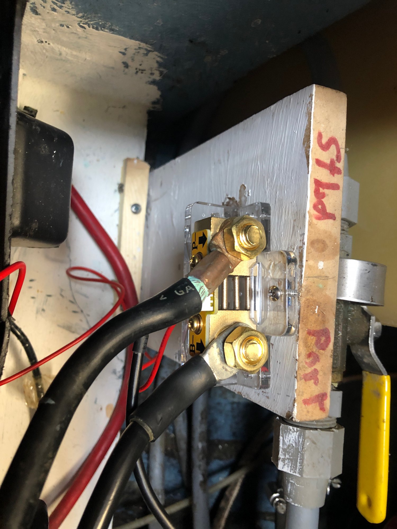

When I installed a shunt for a new battery monitor, I was able to mount it in the battery compartment, on a piece of plywood…
If that spot want available, this compartment has 3 sides that I could use for mounting…
Is your battery compartment completely full if lead? Maybe a photo or 2 would help us visualize.
Yes, you could tab in a mounting block or something to the hull if that is the only space available…just don’t use that are longer than the mounting block is thick…:)
