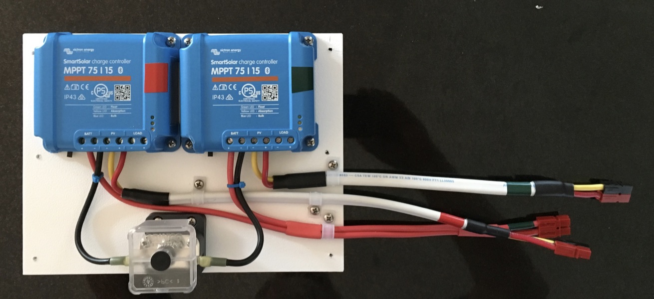

Generally I mount all devices directly to the bulkhead. When I added solar, the controllers required wiring that would be difficult to complete when installed. To make life easier I mounted the controllers to a piece of Starboard with all the connections made with pigtails using Andersen Connectors.
