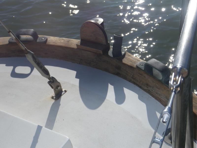

Thanks Chris. Yeah I thought it was kind of strange that the boat did not come with a transom light unless in 1972 when she was built they were not required. The boat did have nav lights which I'm sure were factory installed from the age of them and how they were mounted. I'm going to use my nav lights and stern light for sailing and nav lights and anchor light for power at night. Before anyone starts any fires I checked with the Coast Guard and actually had a member look at my boat and they told me that is perfectly legal. I did not want to mount a "steaming" light on the mast for various reasons. All around white and nav lights =ok for power. Stern light and nav lights =ok for sailing. Thanks again.

Yes my transom has a curve to it although not very pronounced. Clouddiver brought up a good point about the coaming. I may go high with it and put it up there. In my opinion any hole in the boat should be as high as possible and that might give the light the best visibility. The coaming is curved port to starboard to match the transom but it is more vertical then the transom.

Another idea: If your boat has a pushpit rail (Some Oday 22's do, some don't, and I don't think you said one way or the other.), then mounting the stern light on the rail would get it up above the rudder post. Aqua Signal makes a bracket that allows their Series 40 nav lights to be mounted that way.
