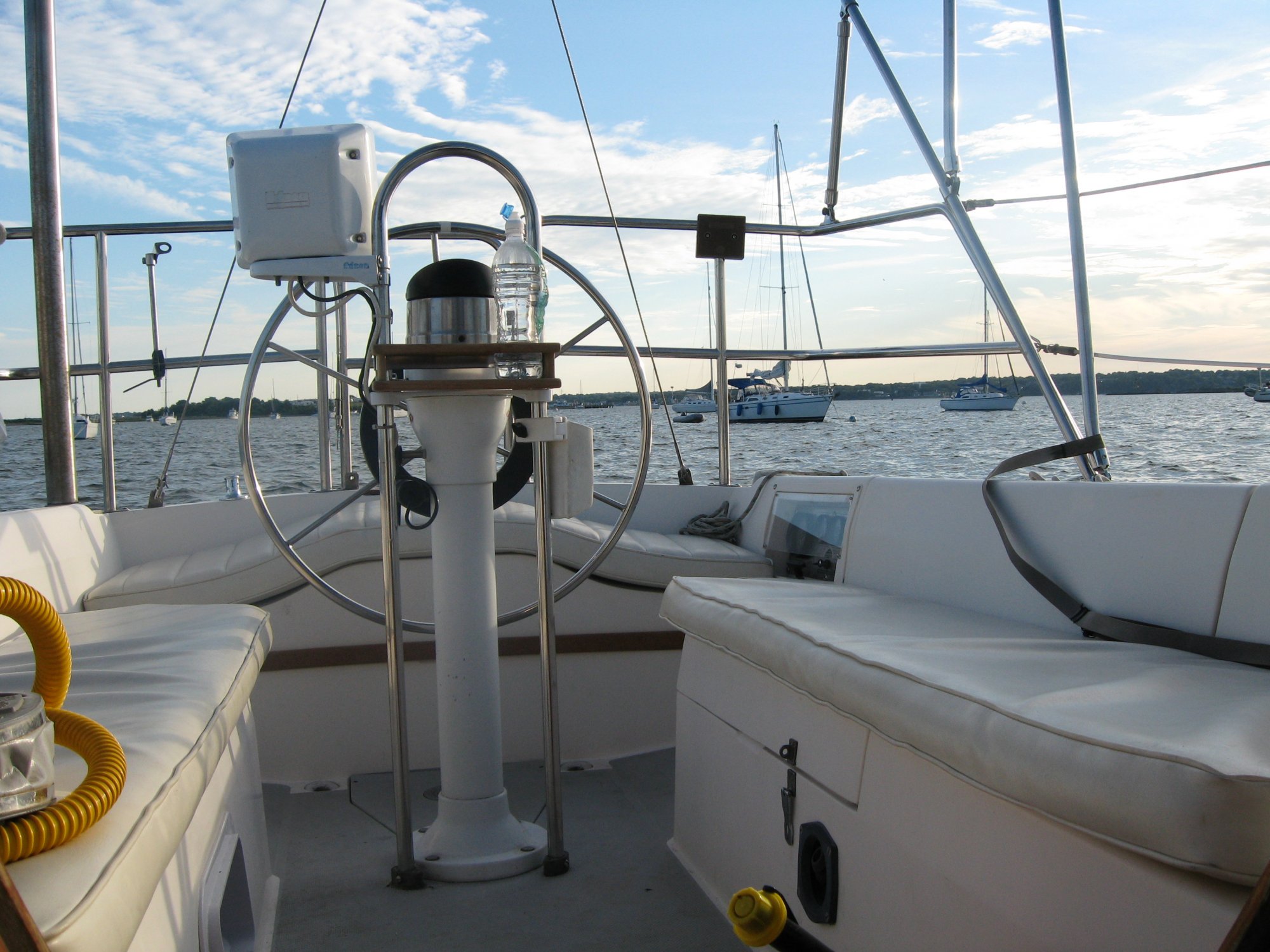

I no longer have my C-30 but I don't think the length of the top pushpit tube from the stern forward is 42" - on my current boat it is 18", I don't think the C-30 could be that much longer if at all. Here's the best picture I have showing my C-30:
I mounted a 50 watt panel on the pushpit at the stern, I don't have room for a 100 watt panel there. I attached aluminum bar stock to the bottom of the panel so I could attach the mounts where I wanted them. You could use aluminum angle "iron" for more strength. Here's the cable gland I used, plenty of room for two 10 awg wires:
Thank you for that info! I think my model of pulpit has longer upper tubes than pictured in your photo, but point taken: I don't think they are nearly 42" in length. So I'm pretty sure I'll have to find a solution like you suggest. And thanks for the cable gland tip! -Tom
