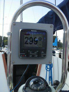

Oct 9, 2008
1,742
Bristol 29.9 Dana Point
I used a Cantex junction box (Pic).
http://www.cantexinc.com/Products/NM_Fittings_Accessories/Junction_Box/Cover.php . 5x5x2.
Reasonable finish, robust PVC construction, color matches instruments, matching squared face, waterproof, mounting tabs, etc. almost like it was designed for the purpose.
I even mounted the GPS to the top, and the RAM3 to the bottom.
3 years and looks like new.
Oh yeah and it was $12.
I ordered mine online but I've since seen them at Lowes Depot.
I also had to buy the mounting things from WM, which were twice what the box cost. But still better that $200-$300 for a marine pod.

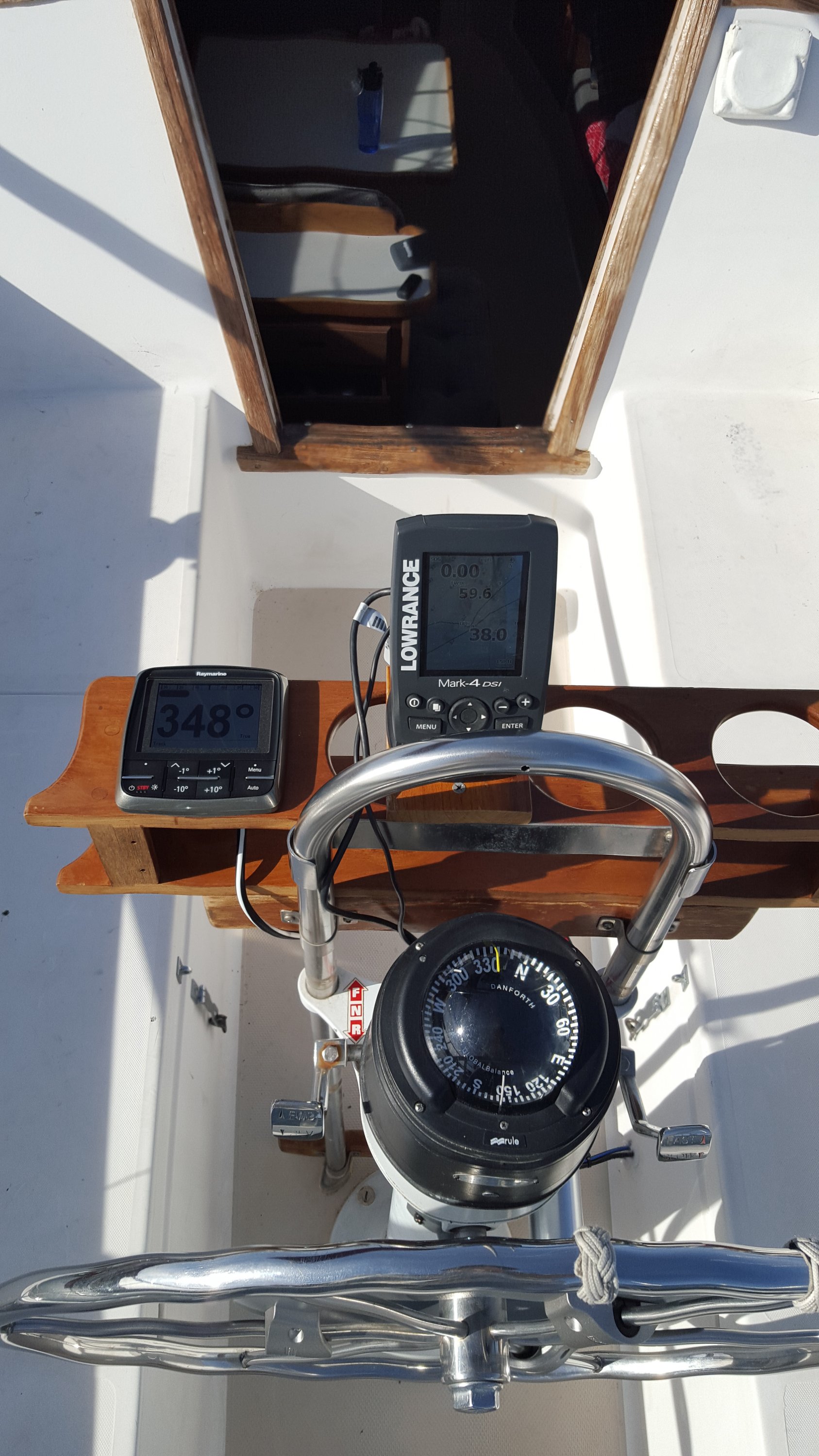

Similar setup on mine. (yes, those are pvc conduit clamps holding it on....might as well stick with the same theme...makes it rotatable too)

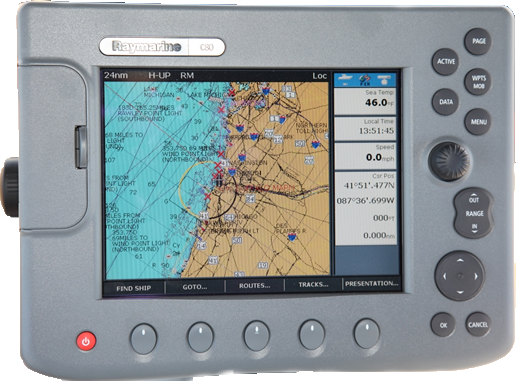

I am trying to mount a Raymarine C-80 on my pedestal, and cant find a cheap way to do it.
I don't want to have to buy a new Edson guard rail but there doesn't seem to be room on the existing pedestal.

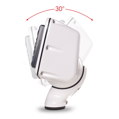

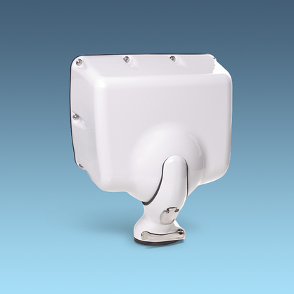

I bought one of these surplus in the box at the Davie FL Marine Flea Market for $40, thinking I could figure out how to mount it to the pedestal.
pyibpodw-2-uc.jpg Power_Pod_Back_View_medium.jpg Forward_and_Aft_Tilt_medium.jpg
But several months later and I am still stumped. Any suggestions or insight would be greatly appreciated. I am looking for a brainstorm thanks.

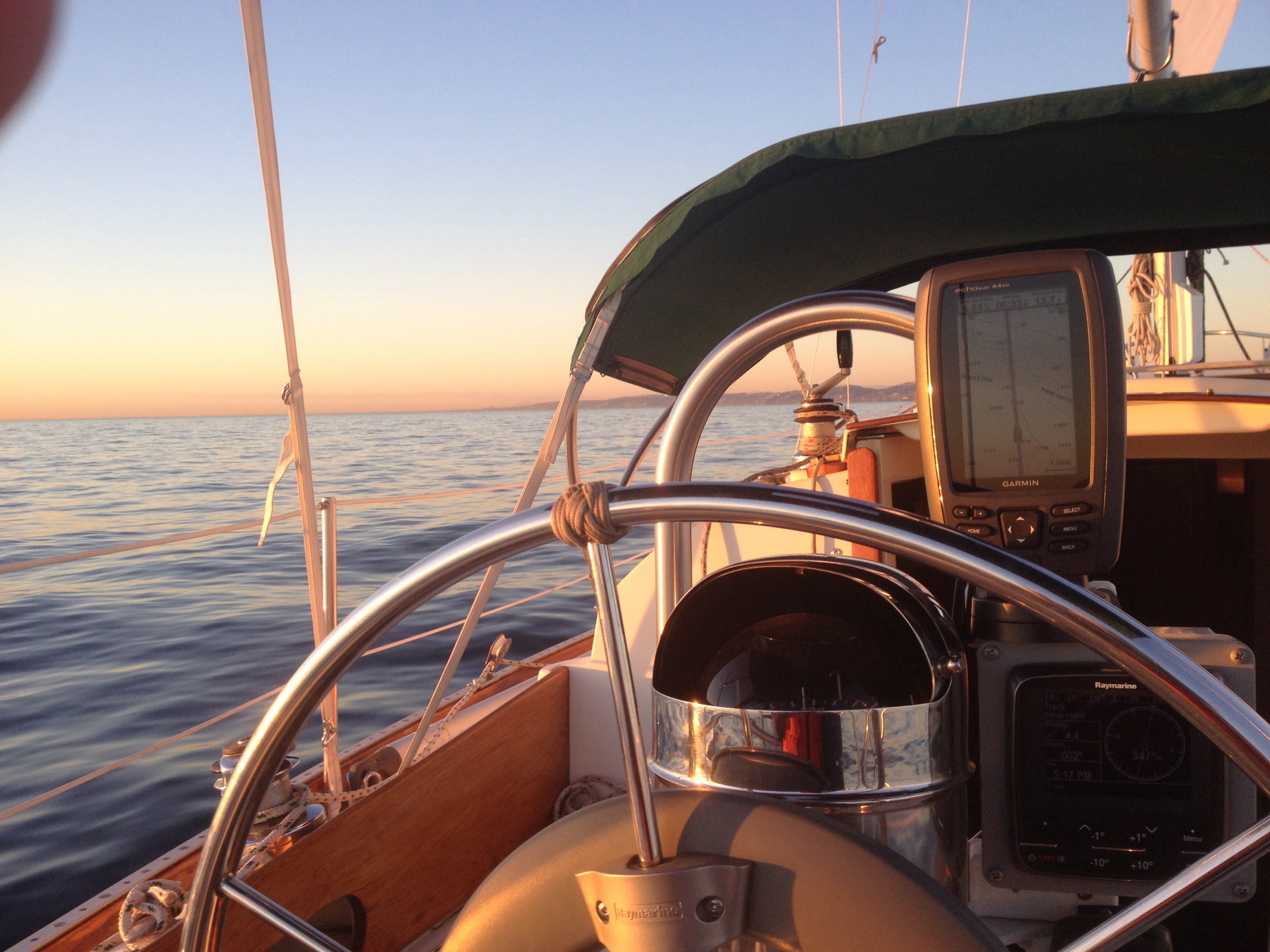

My autopilot is mounted down low next to the engine control panel on the port side at the stern of the boat. I can reach it from the helm, but it would be more convenient on the pedestal.
Sailed my neighbors Catalina 36 last week, and his was mounted on the cabin wall next to the companionway. Both locations work, but closer to the helm may be easier for single handing. depending on where your lines run. If you can control all of your lines from the front of the cockpit, that may be the place to put the autopilot.
