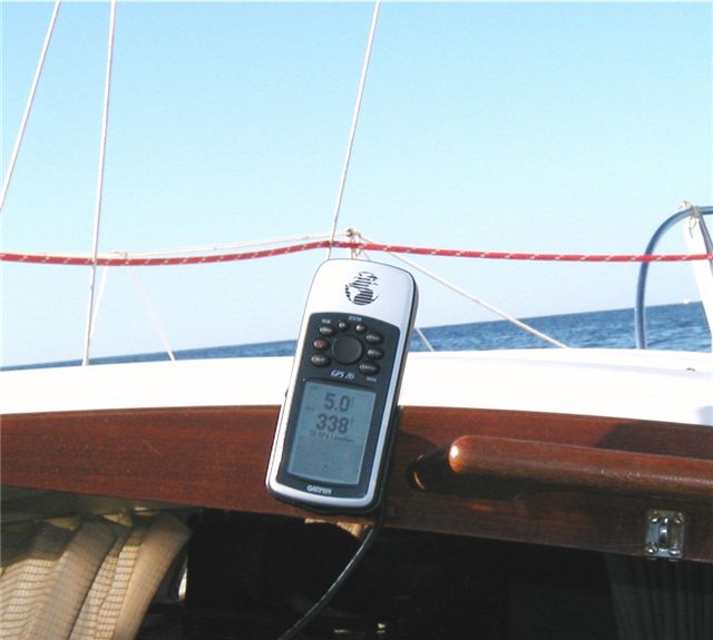

here's how I did mine
... velcro doesn't work well with the 76 becuase the case is slightly curved and there isn't a really good place to attach it. I advise you to mount it high enough so that your passengers don't obstruct your view and you can see it from anyhwhere in the cockpit. As you see, on my C37 the base is screwed into the wood trim along the top of the hatch. The unit is hardwired, left in its bracket and stored in a bulkhead pocket inside the cabin. The wire is 4-5 feet long so I can slip it out of the bracket and hold it or lay it on the bench if I like. If you use batteries it's even easier.
