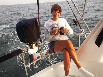

Mine mounts easily
We have our outboard similar to Larry's but on the other side and it works well. The mount is the plastic cheapie from West. The outboard is to the left of the admiral under the blue cover. It does not interfere with the stern lazarette. You can see the plastic mount sticking out. Especially easy to get on and off. I had it on the other side for a while.

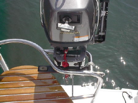

Engine mount on a 410
Nothing works on the 410 because of the angled welds on the stern pulpit. I had the attached fabricated and it came out super. Just make certain that you allow enough space to get the motor's mounting bracket on to the starboard.

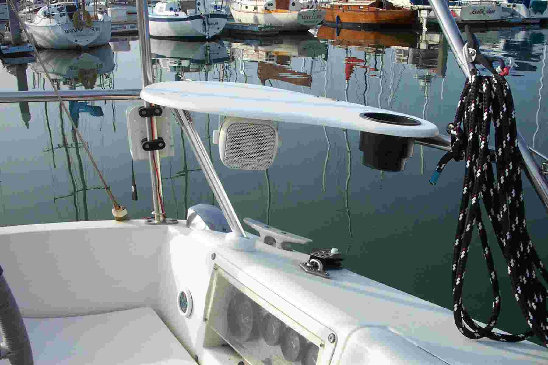

Another picture on the 410
This photo shows the design better.
