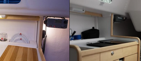

If Catalina installed a VHF radio antenna cable could it be behind the galley close to where these 275 owner's vhf radios are located?
This is where mine is. I don't have a vhf installed but I do have the cable run to this location. Mine is not connected at the mast step so you may have to connect the two ends in the mast.
