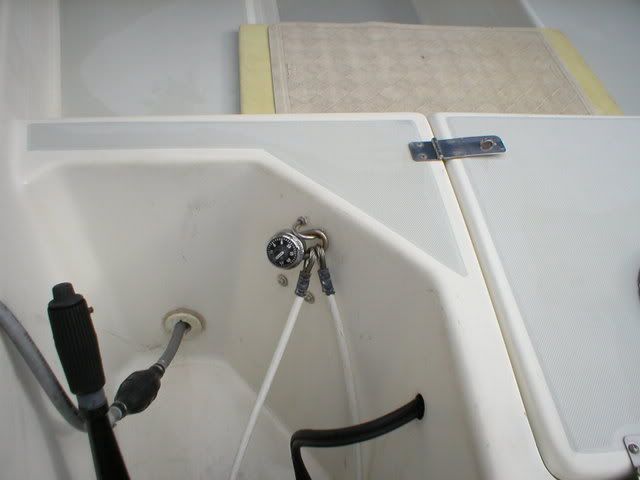

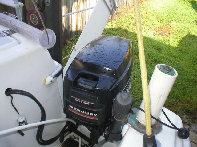

fyi, you might want to add a simple cable like I did: (keeps honest people honest, and the OB connected to the boat...)
http://i64.photobucket.com/albums/h169/ftldiver2/MACGREGOR/P1010015.jpg
http://i64.photobucket.com/albums/h169/ftldiver2/MACGREGOR/PB180012.jpg
