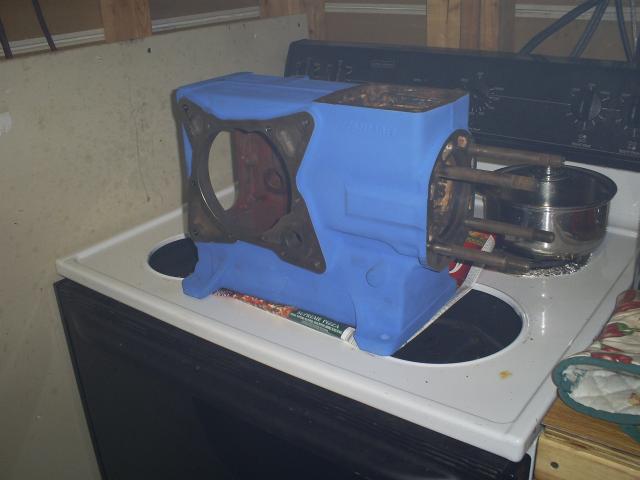

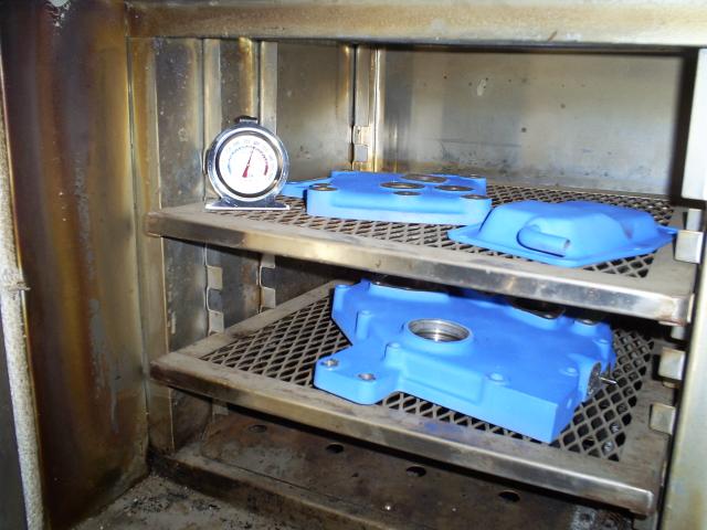

I tore down my little one banger completely. Stripped it down with a wire wheel, and used a bake on paint. I have an industrial oven in my shop which I used for the smaller parts. Unfortunately the block didn't fit sooooo, I used the oven in my kitchen. If you look carefully the picture looks smokey. Aparently there was some oil in some passages that burned out. My wife was a little pissed and thought our oven would poison her. She thought the same thing when I used it for vacuume forming some plastic parts. She eventually gets over it. Women.
Anyway, I didn't tear down the transmission completely so I couldn't bake the paint on. So I painted it with regular engine paint(it was aluminum). I also painted the baked on paint with the same color engine paint(grey).
Now the aluminum parts, whether baked or just engine painted look fine. But the block which is iron has paint flaking off of it and rust showing through after only two years.
I bought a product called Rust Bullet to cover the bolt heads and other parts of the engine. It converts rust and acts as a primer. It is silver colored and sticky. This is the only thing that stopped the rust that I have tried. I could paint ove rthe rust bullet to make it match, but I have another engine I am working on as a replacement to my one banger.
