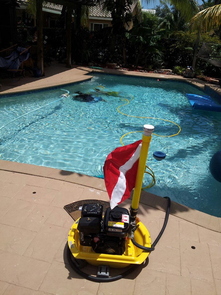

Aug 12, 2014
2,207
I dropped my Brownies hookah dive rig in the water a couple of years ago. It uses a small air cooled 4 stroke Subaru motor to drive the air compressor. I pulled the spark plug, drained the oil and fuel tank. blew out the fuel line, carb and cylinder with compressed air. Dried out the foam air filter with paper towels. Added new oil and new gas. replaced the plug, and she started right up. Ran for 20 minutes, and then replaced the oil again. It was milky. Ran for another 20 minutes. Replaced oil, milky again. After 3 oil changes the oils remained clear. Engine is still fine today.
