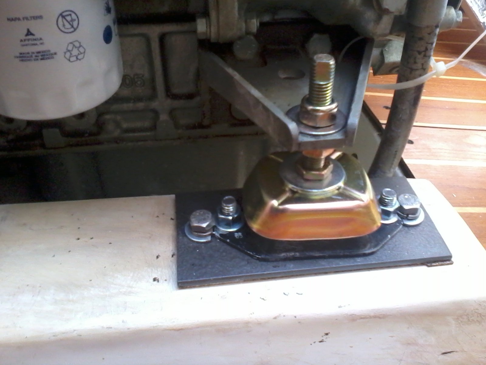

Much as I hate to skunk SBO, I think these are better motor mounts than the OEM, Vetus or others and are a lot cheaper. I put the MM-Small-65 rubber - $35.00/each + M12 height adjuster $12.00 on my boat, You need the mount and the adjuster as a pair. But once you do this you can swap out mount (if ever needed) without lifting the engine. They were even a shade quieter.
I did have to make an adapter plate as the oems were 5" on center and the new ones were 4" on center, but I think that is standard now. FWIW I stink at drilling and tapping.

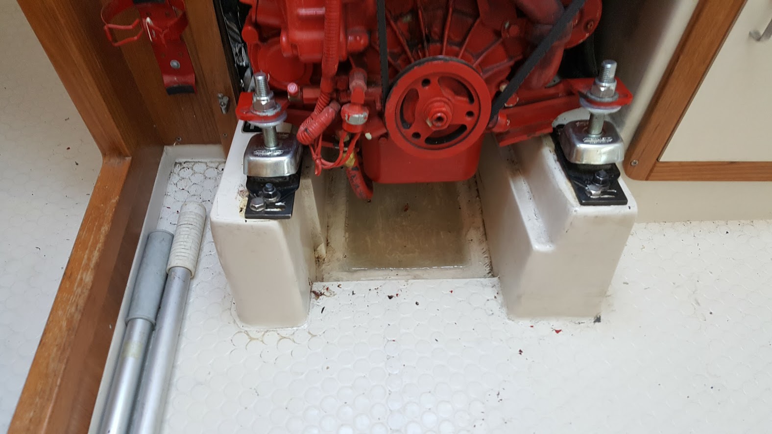

On my Westerbeke, 3 out of 4 mounts were totally useless. The engine was being held down by gravity. The reason I changed them was I replaced my fixed 3 bladed prop with a 2 bladed flexofold prop and the increase in vibration was huge like the boat was trying to shake itself apart. With the new mounts everything is good though I have to avoid 2000 RPM (even at the dock).
I had to make a adapter plate for the holes to line up. I almost screwed myself with height adjuster bolt with the new mount bolt at 12 MM and the hole on the engine bracket at 16 MM. The vendor (missionsuplyonline) had a 12 to 16 MM bolt for that purpose. Doing a engine alignment isn't hard, just needs patience.
