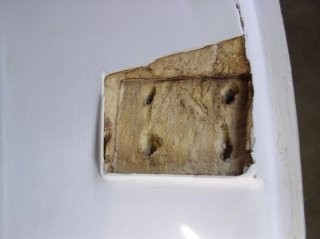

Crappy July 4th this year. I rigged my Hunter 170 and put her in the water this am at 10AM. When I started her outboard and put her in FW gear at 10:15 the motor kicked hard (yes the throttle was in "start" position) and motor was hanging nearly submerged behind the boat as the area surrounding the motor mount almost completely ripped loose. SEE 5 PHOTOS of the damage.
This is a 2006 boat (so just missed the 5 year hull warranty)... made using the now infamous ACP method. Is there a suggested (and reliable) repair for this situation??? I am considering placing a stainless plate on the underside of the boat and thru bolting at this point.

I had the same isue with my 170 and was very successful in repairing the mount. Problem is likely the plywod block embedded in the deck delaminated and the MM screws stayed attached to the upper layers which hinged over. The upper deck is plastic over 3 inches of high density foam and the MM is simply embedded in the foam. My repair involved cutting the plastic skin, fabricating a ply block with ample epoxy sealer, epoxying the block to the hull and building the area with high density expanding foam. Original skin went back on and glued using standare 170 repair methods. Much stronger than before.
I'm typing this on my phone, IM me if you would like more detail

Had a similar problem. However, mine was self inflicted. The boat blew off the trailer with the motor already attached. As you can see, the wood inside was rotted. I dug it all out, cleaned it out, cut a new piece of wood and imbeded it into the hole; replaced the mount using standard gluing prodcedures for ACP. Sanded it down, painted it and it is as good as new. Let me know if you need more picts.

Looking at the two failed mounts, I cant believe they sold the boat with a mount attached that sub standard. In the pics where its ripped open, you can clearly see the mount is fastened to the boat with only wood screws. The wood laminate is also far too undersized for the load IMHO. It was built to fail, basically.
If Hunters only fix would be to repair it back to the same standard, I would pass and make a proper fix. After filling/epoxying the damaged area, you need to through bolt the mount through a larger backer of plywood or metal plate, something covering a much larger area than the mount. It might be a little motor, but that mount is more appropriate for a light trolling motor, and nothing larger. Your lucky you didnt lose the motor to the depths.

That mount should have NEVER been installed with SCREWS!!!!! It should have a substantial backing plate to distribute that load.. That installation is inexcusable......:doh:

Maybe I'm missing something but this doesn't make sense. The damage shown looks like the top of the motor was pulled aft and the prop pushed forward. Like it hung up on something while backing?

I keep coming back to look at the pics, wondering if they really built something that substandard. The pictures speak for themselves, obviously.
I would be curious to know the power rating Hunter gave that mount, as it really doesn't appear adequate for anything more than a trolling motor, and perhaps not even that.
Phil, the bottom of the motor, the prop, is pushing the bottom forward, putting great twisting forces on the mount, basically pulling downward on the back of the motor, the same as you mentioned would happen backing the boat and catching the motor on something submerged.

Yes, they did build the mount this poorly. Rated for 3hp but the mount still depends upon foam and plastic for structural integrity. I can attest that the repair adds great strength.

Okay - an update. The Hunter 170 rubrail is pretty bulletproof. I guess we should be thankful for that! :) I attempted to use acetone to get a section of the aft rail to release with NO success. So I used a cutting disk on my dremel and the remaining 5" of the deck skin was easily removed and so - the motor mount as well.
This left me easy access to the semicircle full of "high density" foam core. I discovered four things:
1. the high density foam is not very dense. It is very easily cut and quite brittle - almost like potato chips. It was very easy to remove cutting & scraping with a small pocket knife.
Video: http://youtu.be/MJVhSAW_qs0
2. the plywood chunk Hunter used beneath the motor mount is high quality plywood but only 3/4" thick (the stainless screws are 2" long) and surprisingly small - about 4" x 5.5". After using a wire brush on the bottom of the motor mount to remove the foam residue I found the plywood to be in perfect condition. I just wish Hunter has used a LARGER, THICKER piece of this stuff!!!!
3. the ACP deck skin surrounding the void had delaminated/UNbonded from the foam about 2-3" surrounding the tear. Cause? Vibration??? I don't know.... Certainly there was no moisture!
4. A BIG surprise. I expected to find nothing but foam - and be able to dig a 4" (approximated) deep void between the deck and hull skins. BUT - about 2" beneath the foam I found a fiberglass "skin" that I did not penetrate. I am assuming this is a wall between the hull foam layer (on bottom) and the deck foam layer (on top). Does anyone know if this is the case? In any case I have a much smaller area to work in than I anticipated.
I plan to "dig" a bit more (another 4" or so towards the bow - & starboard and port around the present void beneath the still intact deck skin) to increase the area of the new buildup area. I'm thinking now that I will use a stainless backing plate beneath a 3/4" piece of plywood or a layer of poured epoxy or fiberglass. Still frames from the video are below. Suggestions/advice welcome. Thx.

Looking at the video the foam looks like it's the same stuff as 'blueboard' insulation found at the big box warehouse stores. I think your plan should work.
I'd use the biggest piece of aluminum or stainless plate I could find to bury in the stern. I'd seal the entire foam area with epoxy. Epoxy in the plate with bolts attached, than use marine ply or the cell foam they use for deck lamination to fill most of the area, than glass. Going with straight epoxy or glass I would think will add a lot of weight.
